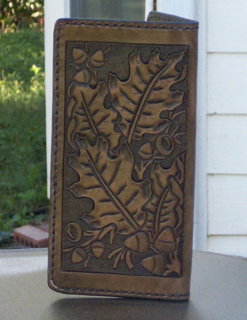

I use both the Tandy Hi-Lighter and the Tandy Gel antique. Both work well. I have had the the most luck with the hi-lighter though. What I do is I spread the Hi-Lighter on thick over the entire surface then I take a damp sponge and wipe off the excess. Use tight circles for both applying the dye and wiping with the sponge. This seams to give me the most consistent look. After the stain dries I use a prevail sprayer to spray on the finish. One thing to note is the prevail sprayer shoots out a ton of finish so make several quick passes do not let the finish pool too much(there will be some pooling) because when it dries you will have a uneven look to the finish. I have yet to try using the sponge with the antique gel but will soon I think it will give me similar results. I have attached an example of the Hi-Lighter. -
