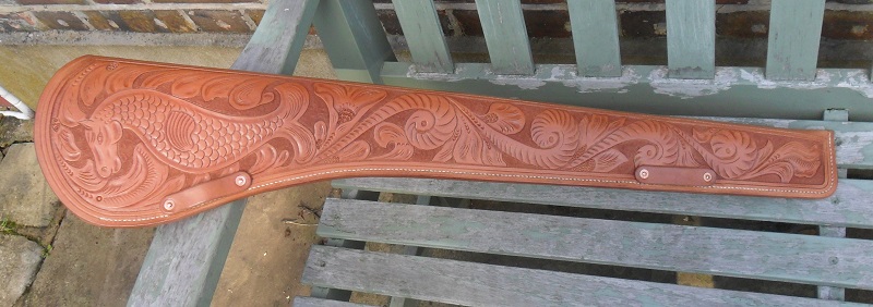

  11. Thanks, pards. Dwight - there are occasional examples from the period of scabbards that have sling retainers only on the back. The aim is to not interfere with the tooling. For an example, have a look at page 91 of Cowboys and The Trappings of the Old West.
  12. The three scabbards I've made...
  13. Thanks, pards, for the kind words. It's a copy of an original from ca 1890.
  14. A tooled scabbard ca 1890 from page 91 of Cowboys & the Trappings of the Old West.

  16. That is a heck of a lot of work. Well done.
