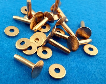

Members JShapiro Posted July 29, 2022 Members Report Posted July 29, 2022 Hi, I'm making some canoe portage packs and am looking to rivet the leather straps onto the canvas pack. I'm using an existing pack as a pattern. I'd like to find rivets like these, which are going through 4 layers of leather (1 is inside the pack as a reinforcement) and 2 layers of thick canvas. For scale, the leather strap is about 1" wide. Can someone post a link to where I might buy some? I've searched online but have been overwhelmed by all the options and haven't found what I'm looking for. Thanks! Another photo of buckle assembly from the side, showing how long the rivet is: Quote
Contributing Member fredk Posted July 29, 2022 Contributing Member Report Posted July 29, 2022 Without seeing the back side, I think they are brass Saddlers Rivets https://www.tandyleather.world/products/rivets-burrs?_pos=3&_sid=201fe85b4&_ss=r Quote Al speling misteaks aer all mi own werk..
CFM chuck123wapati Posted July 29, 2022 CFM Report Posted July 29, 2022 they are just copper rivets you can get them from weaver leather, tandy, or most any leather craft or hardware storehttps://tandyleather.com/collections/hardware/products/rivets-burrs Quote Worked in a prison for 30 years if I aint shiny every time I comment its no big deal, I just don't wave pompoms. “I won’t be wronged, I won’t be insulted, and I won’t be laid a hand on. I don’t do these things to other people, and I require the same from them.” THE DUKE!

Members JShapiro Posted August 23, 2022 Author Members Report Posted August 23, 2022 OK, I'm finally getting around to ordering materials for this project. I need the rivets to go through approximately 1/2" of material (leather plus canvas). Should I get 3/4" or 1" post length? Thanks! Quote
Contributing Member fredk Posted August 23, 2022 Contributing Member Report Posted August 23, 2022 If you are sure its about 1/2" of material then 3/4" will do Quote Al speling misteaks aer all mi own werk..
Members jcuk Posted August 23, 2022 Members Report Posted August 23, 2022 I would go for a 1'' you can cut down to the size you need, you cant add any any length if they are to short. Hope this helps JCUK Quote
Members battlemunky Posted August 23, 2022 Members Report Posted August 23, 2022 19 minutes ago, jcuk said: I would go for a 1'' you can cut down to the size you need, you cant add any any length if they are to short. Hope this helps JCUK This^^^ It's rare that we get hardware that is one size fits all but with bit/burr rivets we can. Just get the long ones and trim them...you'll have to trim them anyhow so no need to stock more types than you need. Last time I bought them they were the same price regardless of length too. Quote

Members JShapiro Posted August 27, 2022 Author Members Report Posted August 27, 2022 (edited) On 8/23/2022 at 4:06 PM, battlemunky said: This^^^ It's rare that we get hardware that is one size fits all but with bit/burr rivets we can. Just get the long ones and trim them...you'll have to trim them anyhow so no need to stock more types than you need. Last time I bought them they were the same price regardless of length too. What is the best method for cutting them down? And if I cut them down, how much should I leave to hammer over? EDIT: Never mind, I found a good video on Buckleguy website. Thanks for your help, everybody! Edited August 27, 2022 by JShapiro Quote
Members battlemunky Posted August 27, 2022 Members Report Posted August 27, 2022 23 minutes ago, JShapiro said: What is the best method for cutting them down? And if I cut them down, how much should I leave to hammer over? EDIT: Never mind, I found a good video on Buckleguy website. Thanks for your help, everybody! It took me a little trial and error to get them where I like them. I took a piece of 3 oz leather and punched a hole in it to make a standoff, I set the rivet and then put the standoff over the stem and then use my side cut pliers flush with the standoff and it's where I like it. As long as the rivet is secure it should be fine so there is a little bit of feel to figuring out how much you like vs how much you don't. I found this to be the case anyhow. Too little is bad and too much is, well, too much...you have to find your inner Goldilocks. Quote
