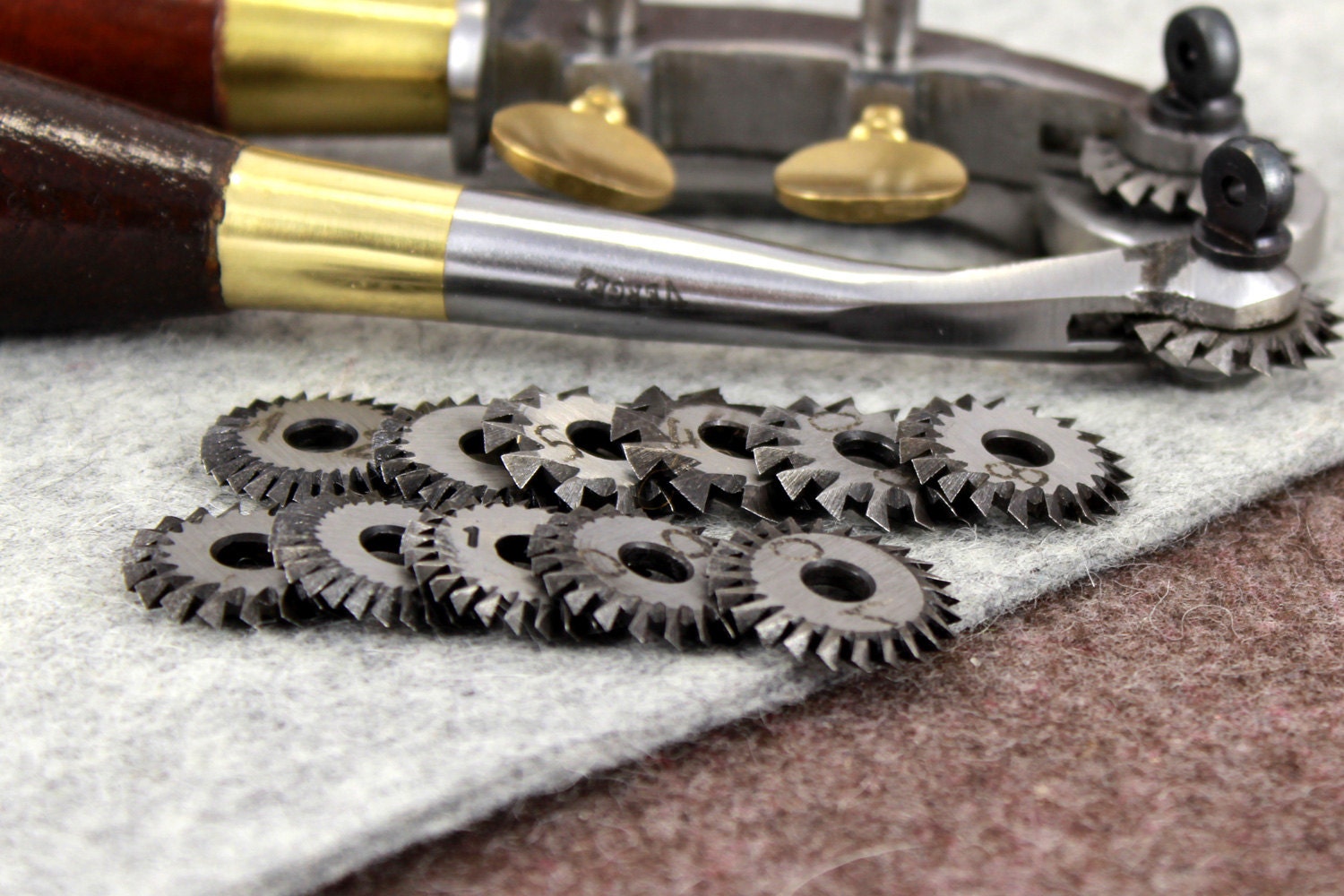

YinTx Report post Posted August 29, 2023 1 hour ago, Klara said: If I remember correctly, Stohlman rolls the wheel in the groove he cuts. Which sounds doable to me. The reason I didn't buy a wheel when I started was that the sales lady warned me that the markings are not slanted, unlike a pricking iron. But now I'm getting curious... My Vergez Blanchard wheels leave slanted marks... a pouncing wheel does not tho. Quote Share this post Link to post Share on other sites
Tugadude Report post Posted August 29, 2023 2 hours ago, Klara said: If I remember correctly, Stohlman rolls the wheel in the groove he cuts. Which sounds doable to me. The reason I didn't buy a wheel when I started was that the sales lady warned me that the markings are not slanted, unlike a pricking iron. But now I'm getting curious... Yes, but a stitching groove is objectionable to some. Perhaps many. It is said by some to be an "American" thing mainly. And all the arguments ensue about how recessing the thread makes the item more durable. Then the other side says, maybe, but you are also weakening the leather by removing the upper layer and if you groove too deeply it could be an issue. And then they point to 100 year old European saddles with thread sitting up proudly with no issues whatsoever, especially for the age. My main issue with a stitching groove is it causes my stitching to lose most of its slant, and slanting stitching appeals to me and my idea of aesthetic. Quote Share this post Link to post Share on other sites
Tugadude Report post Posted August 29, 2023 43 minutes ago, YinTx said: My Vergez Blanchard wheels leave slanted marks... a pouncing wheel does not tho. I know that you know this, but for beginners here. A pricking wheel has slanted tines whereas the basic overstitching wheel has points. The pricking wheel is far superior in that it gives you the angle to follow and makes it easier to keep all of the holes at the same angle. I even found an overgroover with two wheels, to mark parallel lines! How cool is that? Quote Share this post Link to post Share on other sites
