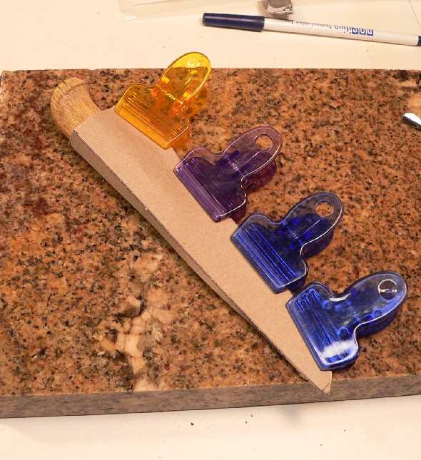

electrathon Posted February 15, 2008 Report Posted February 15, 2008 I make a lot of knife sheaths. The cardboard from cerial/food boxes is great for a first template. Then transfer it to the leather once the size and shape is determined. Aaron Quote

Billsotx Posted February 15, 2008 Report Posted February 15, 2008 (edited) I make a lot of knife sheaths. The cardboard from cerial/food boxes is great for a first template. Then transfer it to the leather once the size and shape is determined.Aaron I with Aaron on boxes and manila folders for patterns. If you mess one up and you will don't be so quick to toss, especially if you're half-way there. If you cut too much off or punch a whole in the wrong place tape it back and move on. When you get it right then redo you're working template. Masking tape, duct tape and carton tape are always close at hand. When I open glue or dye it over an old cereal box. I varnished over a huge blotch of USMC black right in the middle of my work bench, left as a reminder - Don't dye stuff without covering me up. ... Luckily the varnish worked because rub-off was endless. I could have easily replaced the top of the bench, but I need reminders. ... Eat cereal! We need more boxes! ... lol! Good thread here Johanna! Edited February 15, 2008 by Billsotx Quote
