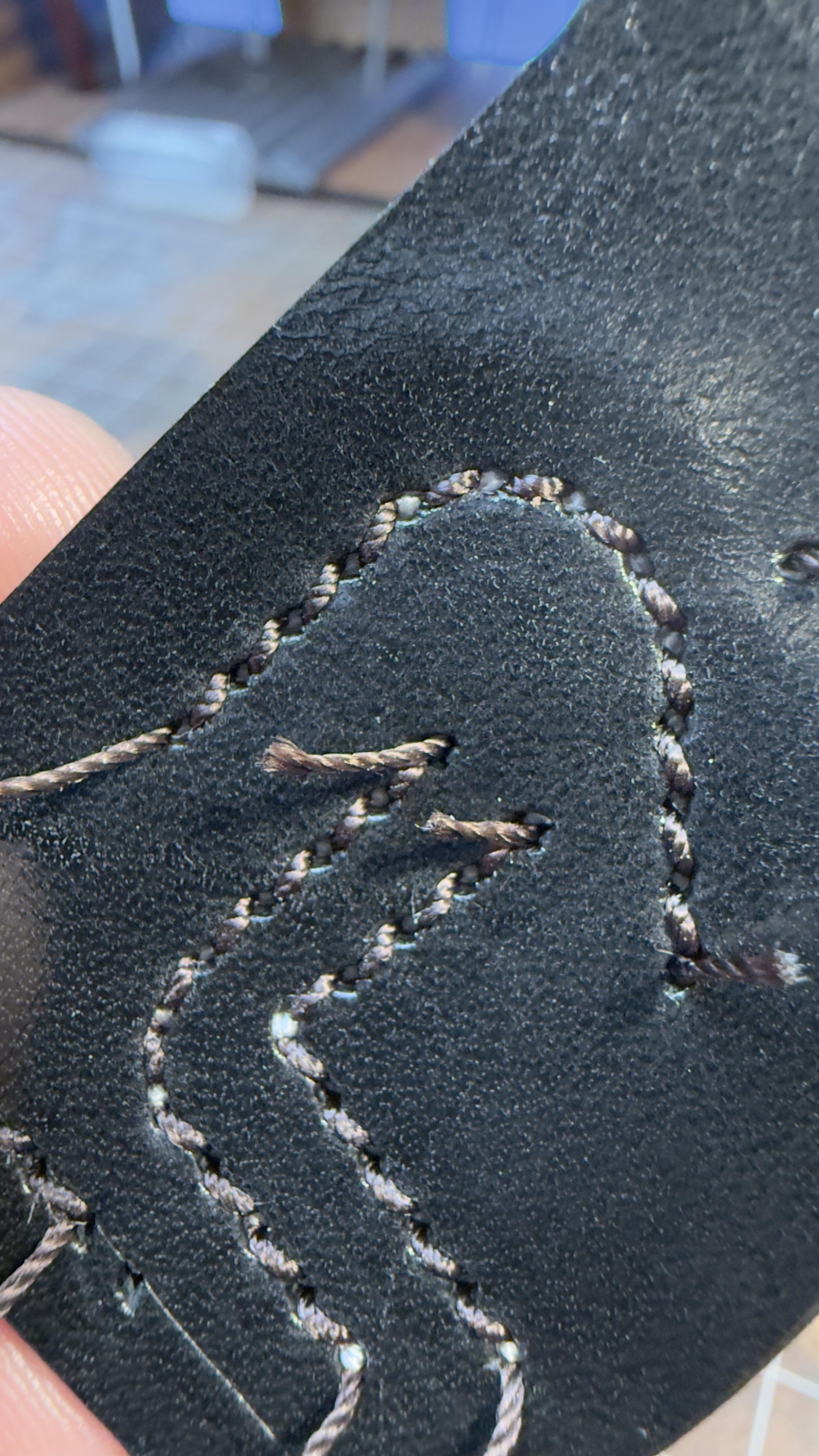

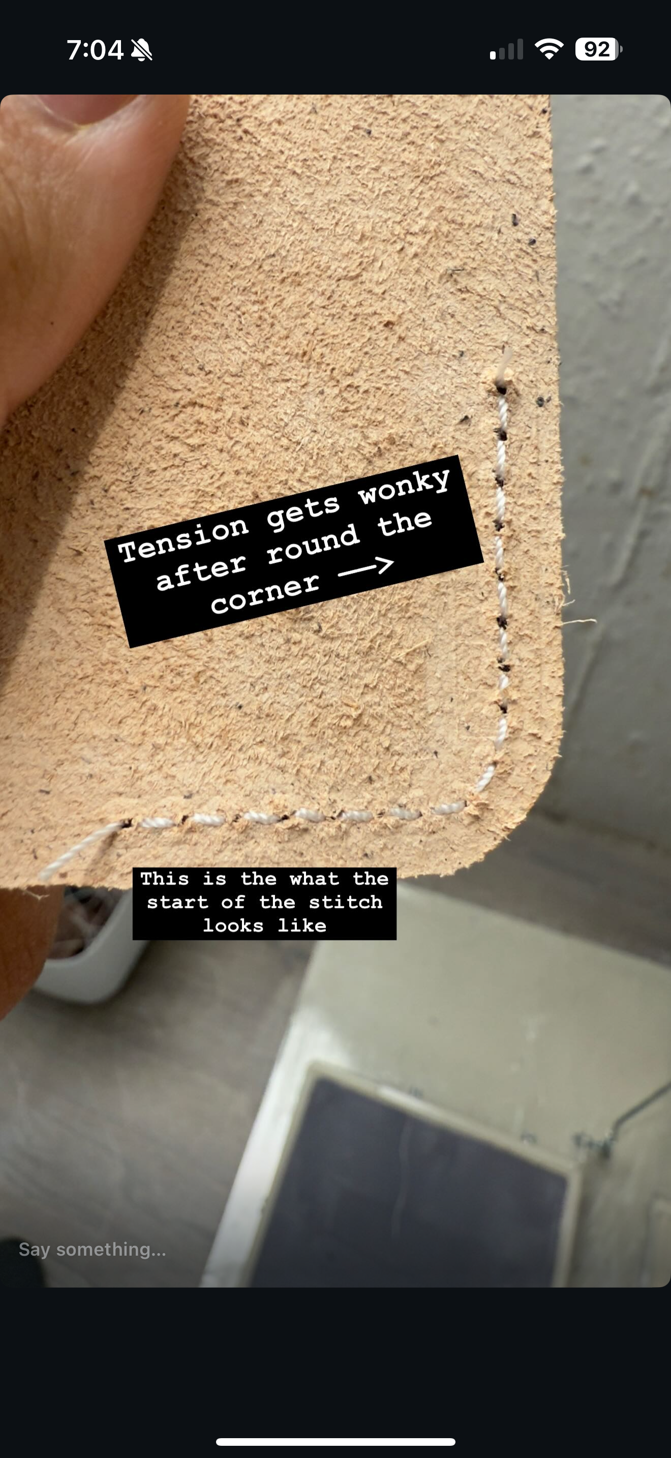

Hello, having some tension issues when seeing corners or making 90° turns. I’ve re-threaded so many times, changed the bobbin, changed needles, tried smaller thread and needles, cleaned the tension discs and bobbin area, and seemed to have done just about everything I can find online to remedy this.
The tension looks great when sewing a straight line. No loops on the top or bottom and it looks like thread is meeting in the middle. The only issues happen when sewing anything other than a straight line.
I’m using size #138 thread and a 136x16RTW needle size 23.
Any ideas?

Looking at your photos the leather looks very thin which means there is very little thickness to constantly bury / hide the bottom knot in.
I would suggest:
i) you try again with either thicker leather or a few layers of thin leather to give the needed space to burying the knot.
ii) you lock the starting stitches.

Needle timing and tension release.  Just because it sews in a straight line doesn't mean it will turn a corner.  A little up and down on the needle may help.  Also look where in the lift cycle when the thread releases, should be near the top.  Your picture indicate that may be the problem.
