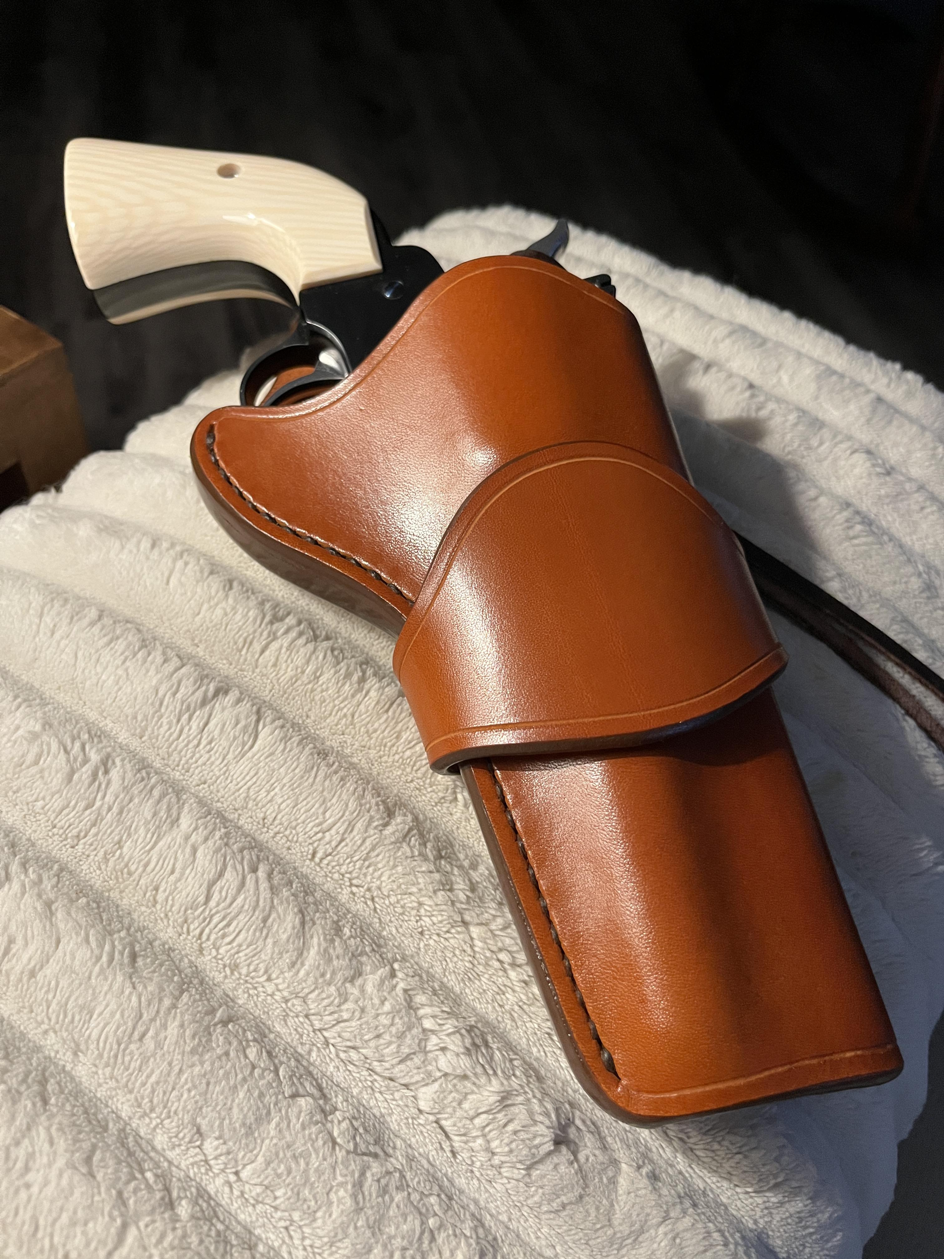

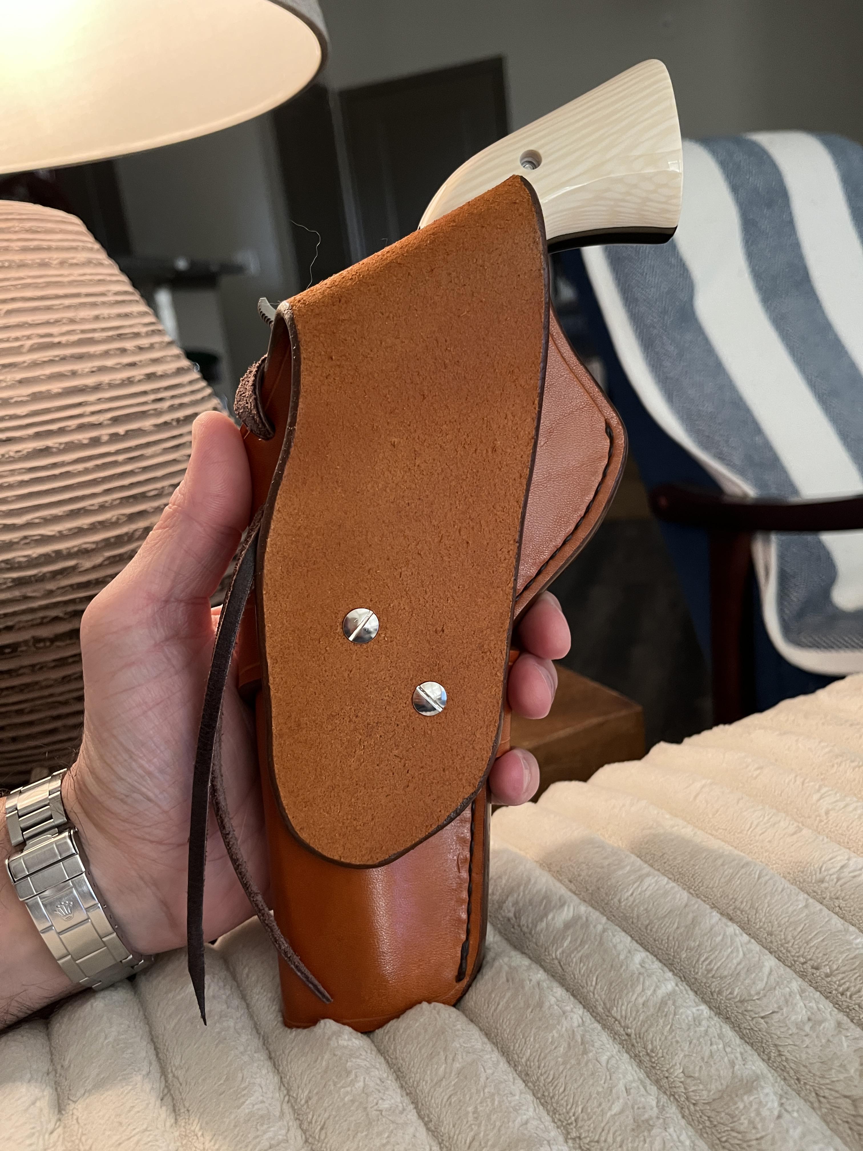

Members DeWayne Hayes Posted Thursday at 01:37 PM Members Report Posted Thursday at 01:37 PM (edited) Folks, I have made a holster that has some Chicago Screws, and I can't figure a good way to tighten them when one side is domed/slotless. Finger pressure goes so far, but then the domed side just turns. Does anyone have a trick? Rubber washer, maybe? Contact cement in place of a washer on the domed side? Anything else? Thanks, DeWayne Edited Thursday at 01:37 PM by DeWayne Hayes Quote

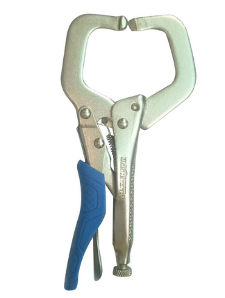

Members JREESER1 Posted Thursday at 01:53 PM Members Report Posted Thursday at 01:53 PM I always add a small drop of blue Locktite into the inside (female) threads. Then, put just enough pressure with very light touch of loose adjusted small vise grips to the edge of female side of the screw, so you will not mar the screw and lightly tighten. Never had any problems. Quote

Members DeWayne Hayes Posted Thursday at 02:11 PM Author Members Report Posted Thursday at 02:11 PM Thanks, folks. My leather is thick enough that the screw isn't bottoming out, it just can't grab firmly enough on the leather to really dig in and stop spinning. It tightens ok, just not as tight as I'd like. This is only exacerbated by the fact that when I attach the second one, I can no longer get my finger in there to hold it as there's no room. I think I may try a drop of contact cement on the lip of that female domed head. I suspect that's going to stop the spinning. Worst case scenario, the leather loop it's attaching to can be replaced easily enough if I ever have to. This was the first western style revolver holster I've made - all my holster making to this point has been thumb-break style for automatics. Being able to connect a loop in the back with Chicago Screws is such a pleasure - saves a ton of stitching for the belt loop. Quote

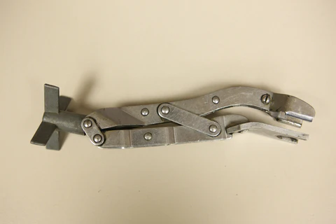

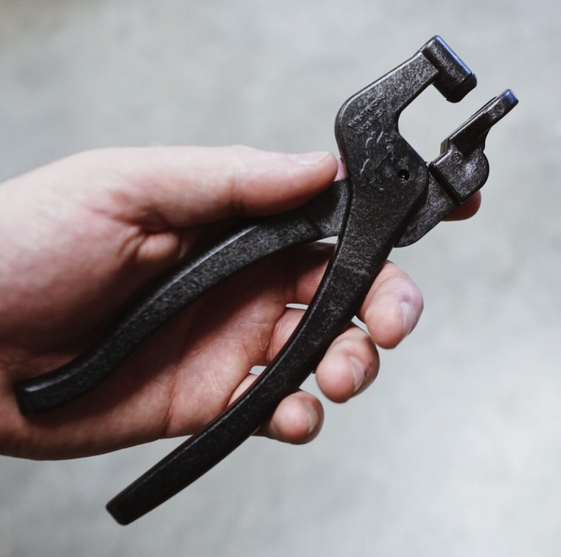

Northmount Posted Thursday at 09:23 PM Report Posted Thursday at 09:23 PM 7 hours ago, DeWayne Hayes said: Folks, I have made a holster that has some Chicago Screws, and I can't figure a good way to tighten them when one side is domed/slotless. I use a JP Tack Tool like this. Or like this one. Quote
AlZilla Posted Thursday at 10:05 PM Report Posted Thursday at 10:05 PM @PastorBob These are a slot and a Philips. Somewhere I have slot/Allen, too. When I get to a big computer I'll find the Amazon link, because that's where I actually ordered from. Quote “Those who can make you believe absurdities can make you commit atrocities.” - Voltaire “Republics decline into democracies and democracies degenerate into despotisms.” - Aristotle
AlZilla Posted Thursday at 10:08 PM Report Posted Thursday at 10:08 PM 43 minutes ago, Northmount said: I use a JP Tack Tool like this. Or like this one. Well, that is cool. The first one won't load for me but the second one does. In the OPs case, that one won't get deep enough to help him, but still very cool. Quote “Those who can make you believe absurdities can make you commit atrocities.” - Voltaire “Republics decline into democracies and democracies degenerate into despotisms.” - Aristotle
Northmount Posted Thursday at 10:30 PM Report Posted Thursday at 10:30 PM 19 minutes ago, AlZilla said: Well, that is cool. The first one won't load for me but the second one does. In the OPs case, that one won't get deep enough to help him, but still very cool. Loads for me. It has even less reach. It would be relatively easy to modify the reach, or build one with longer reach. Just need to see the idea to make one. Quote
Members TomG Posted Friday at 12:11 AM Members Report Posted Friday at 12:11 AM 2 hours ago, Northmount said: I use a JP Tack Tool like this. Or like this one. I use the one from Weaver. Pricey, but worth it. Be sure to order a few spare rubber 'faces' for the jaws. They will wear out over time. I used to make specialty leashes that had about 8 Chicago screws holding things together. I used a small drill with a Phillips bit to set them. I also used the blue Harbor Freight version of Loc-Tite. Worked great. Quote Tom Gregory Legacy Leathercraft www.legacyleathercraft.com www.etsy.com/shop/legacyleathercraft
Contributing Member fredk Posted Friday at 02:08 AM Contributing Member Report Posted Friday at 02:08 AM (edited) That one on Weaver started out life as valve sleeve installers.* I once had them for installing valves on my cars PS. the first one opens a page but no picture shows on it *edit; just remembered the name; valve spring compressor Edited Friday at 02:39 AM by fredk Quote Al speling misteaks aer all mi own werk..

Contributing Member Samalan Posted Friday at 11:29 AM Contributing Member Report Posted Friday at 11:29 AM Cut a slot in each side a pair of pliers in the nose end very close to the front surface with a Dremel tool, grind the nose to a very slight dish, this will hold the smooth side of your screw, then use some blue when you put it together. this is the best way, IMHO, that is to say, I have never found anything better and don't need to. Quote
Northmount Posted Friday at 02:01 PM Report Posted Friday at 02:01 PM 11 hours ago, fredk said: the first one opens a page but no picture shows on it Quote
Members DeWayne Hayes Posted Friday at 02:49 PM Author Members Report Posted Friday at 02:49 PM That's a cool tool when there is clearance on both sides, but I could never get it in there between the flap and the holster without bending or scarring the leather. The flap is pressed down tight to the holster body. I'm thinking a thin rubber washer or, as I said, a spot of contact cement might be my strategy. I'll try the rubber washer tactic first and see how it does. Thanks, folks. DeWayne Quote
Contributing Member fredk Posted Friday at 02:52 PM Contributing Member Report Posted Friday at 02:52 PM 12 hours ago, fredk said: That one on Weaver started out life as valve sleeve installers.* I once had them for installing valves on my cars *edit; just remembered the name; valve spring compressor I wonder if valve spring compressor proper would do the job. They usually can be bought in automotive supply stores or at garage sale for few bucks @Northmount ; thank you Quote Al speling misteaks aer all mi own werk..
Northmount Posted Friday at 03:19 PM Report Posted Friday at 03:19 PM (edited) 29 minutes ago, fredk said: I wonder if valve spring compressor proper would do the job. They usually can be bought in automotive supply stores or at garage sale for few bucks @Northmount ; thank you I guess it depends on the style. One my Dad had, had a screw handle on it instead of a lever. The one I have reaches around the head (valve in head) and has a long cumbersome reach for something like this. The screw clamp reached in the side of the engine block for the valve in block engine. This would be the type of clamp, locking pliers, vice-grip (multiple trade names) to modify to make a long reach Chicago Screw clamp. Has lots of height, lots more than needed, could be lengthened for longer reach, and could be modified so one side can be slide inside a small space. Wouldn't be too hard to do. Make ends like the Weaver clamp. I had a welding clamp very similar to this one. Maybe wasn't designed for welding as the spring failed! Probably didn't like high current flow circulating thru the clamp when the 2 objects being welded didn't have a good electrical connection. Gave it to my son along with my 325 A AC welder and some other welding tools. Edited Friday at 03:25 PM by Northmount added comment Quote
Contributing Member fredk Posted Friday at 05:05 PM Contributing Member Report Posted Friday at 05:05 PM 2 hours ago, fredk said: I wonder if valve spring compressor proper would do the job. On second thoughts. they would not do the OP. The screw bar would be on the wrong side as it were Quote Al speling misteaks aer all mi own werk..

Northmount Posted Sunday at 06:10 PM Report Posted Sunday at 06:10 PM On 5/9/2025 at 11:05 AM, fredk said: On second thoughts. they would not do the OP. The screw bar would be on the wrong side as it were That is similar to mine. Below is the style my Dad used (for valve in block). Neither of these would make a good tool for Chicago screws. Quote
