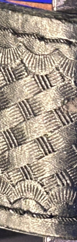

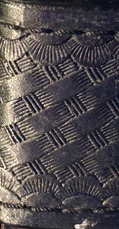

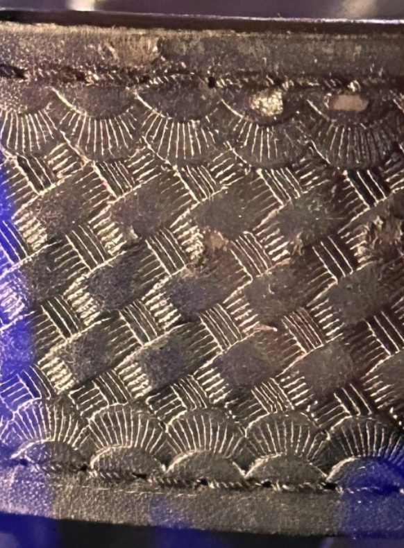

Members Shimo Posted Monday at 10:53 AM Members Report Posted Monday at 10:53 AM (edited) Hello I am a complete beginner and came across this excellent forum by chance (google :D). I would like to attempt replicating a specific belt from a movie. I have several pictures of the belt but have been unable to identify the basket weave stamp used here. Is this perhaps an old stamp that is no longer in production? Maybe someone recognizes it and could provide some information about the stamp 😊 The belt itself should be approximately 2.25 inches wide. Therefore, I estimate the height of the stamp to be around 0.2 inches, which seems like an unusual size. Here are a few pictures of the belt: All the basket weave stamps I find online do not have these 6 "points/rdiges" but rather more or fewer, or a different form of "points/ridges". If you have any Tips/hints for the exact camouflage stamp, of course that would be very helpfull too! Thank you very much for your assistance - any help would be awesome! Edited Monday at 12:05 PM by Shimo typo Quote

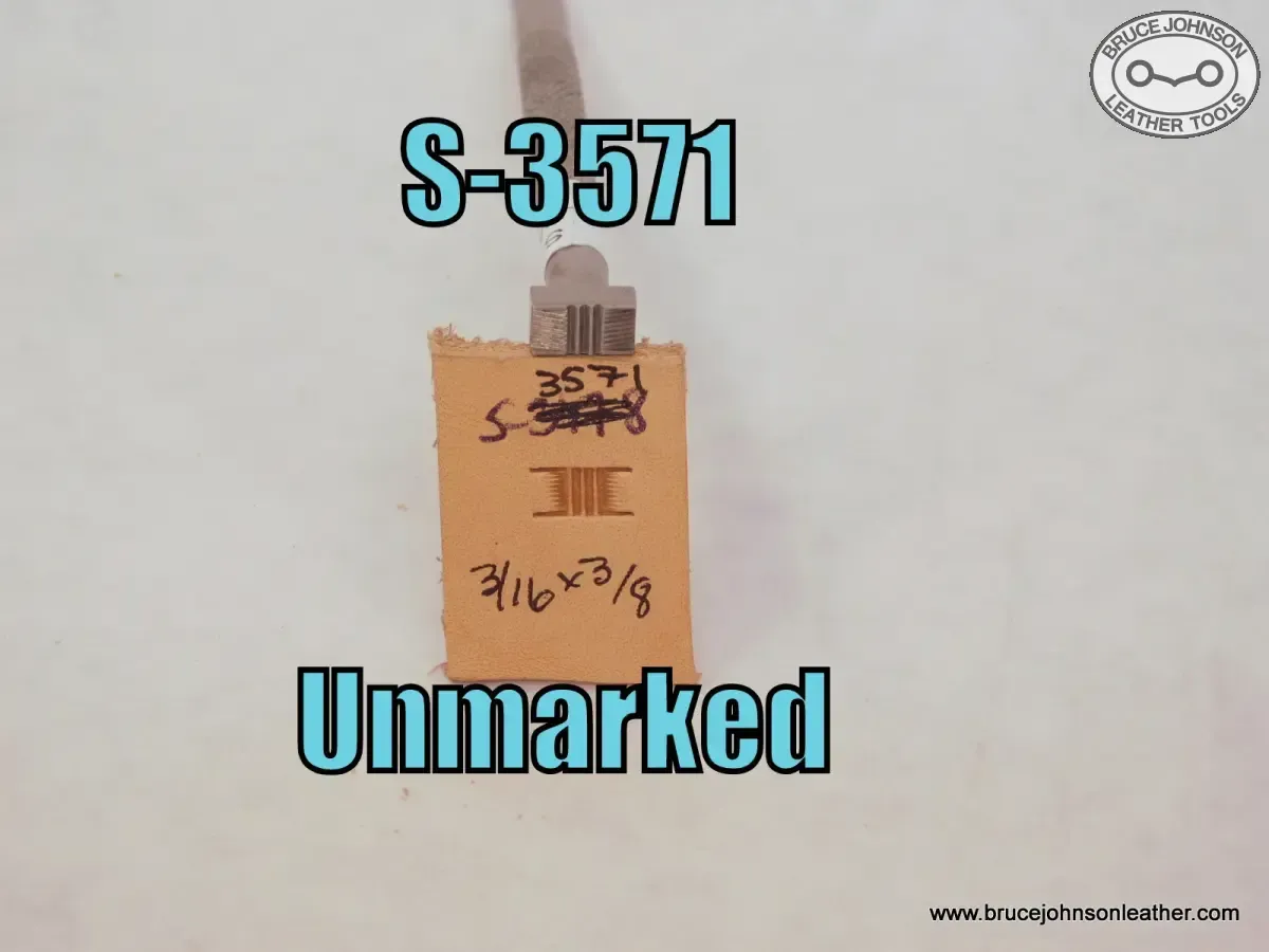

Moderator bruce johnson Posted yesterday at 04:09 AM Moderator Report Posted yesterday at 04:09 AM 0.2 inches is about 3/16 inch and a common size for basket stamps. Closest I've got is this probably McMillen as far as dimensions and pattern. It has more weave accent lines though. Here's what I've got - https://brucejohnsonleather.com/products/stamping-and-carving-tools/basket-stamps Quote Bruce Johnson Malachi 4:2 "the windshield's bigger than the mirror, somewhere west of Laramie" - Dave Stamey Vintage Refurbished And Selected New Leather Tools For Sale - www.brucejohnsonleather.com
