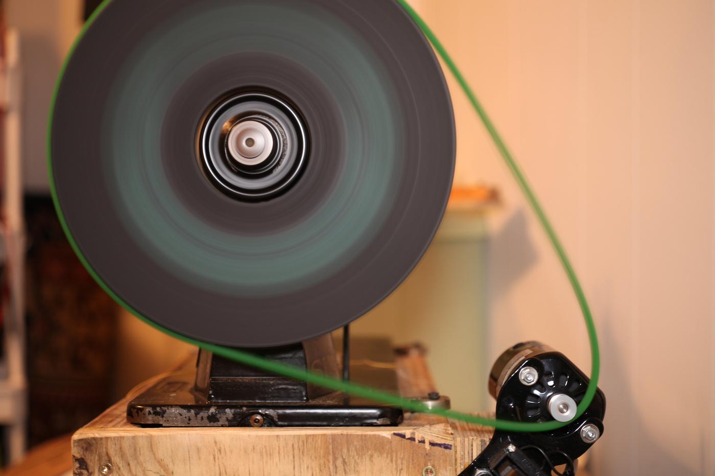

Contributing Member friquant Posted February 20 Author Contributing Member Report Posted February 20 UPDATE: Since becoming more acquainted with domestic sewing machines and their low-power plain-bushing motors, I have started choosing belt tension that optimizes for best top speed. That is, looser belt tension than before. (This is 5mm PU belt for reference.) Top speed of the machine head is now 750rpm with no bobbin case, no thread, and presser foot up. Also fun to watch it spool up, as the belt shape becomes asymmetrical. This photo taken right after stepping on the pedal. Here's a demonstration of varying belt tension with a domestic motor and how it changes top speed. (Listen to the hum of the machine head to judge speed) On 2/5/2026 at 11:27 PM, Darren Brosowski said: Ahhh grasshopper you have mastered the art of doing things that work despite what everyone else thinks Ah, well 😊 Quote friquant. Like a frequent, piquant flyer. Check out my blog: Choosing a Motor for your Industrial Sewing Machine
