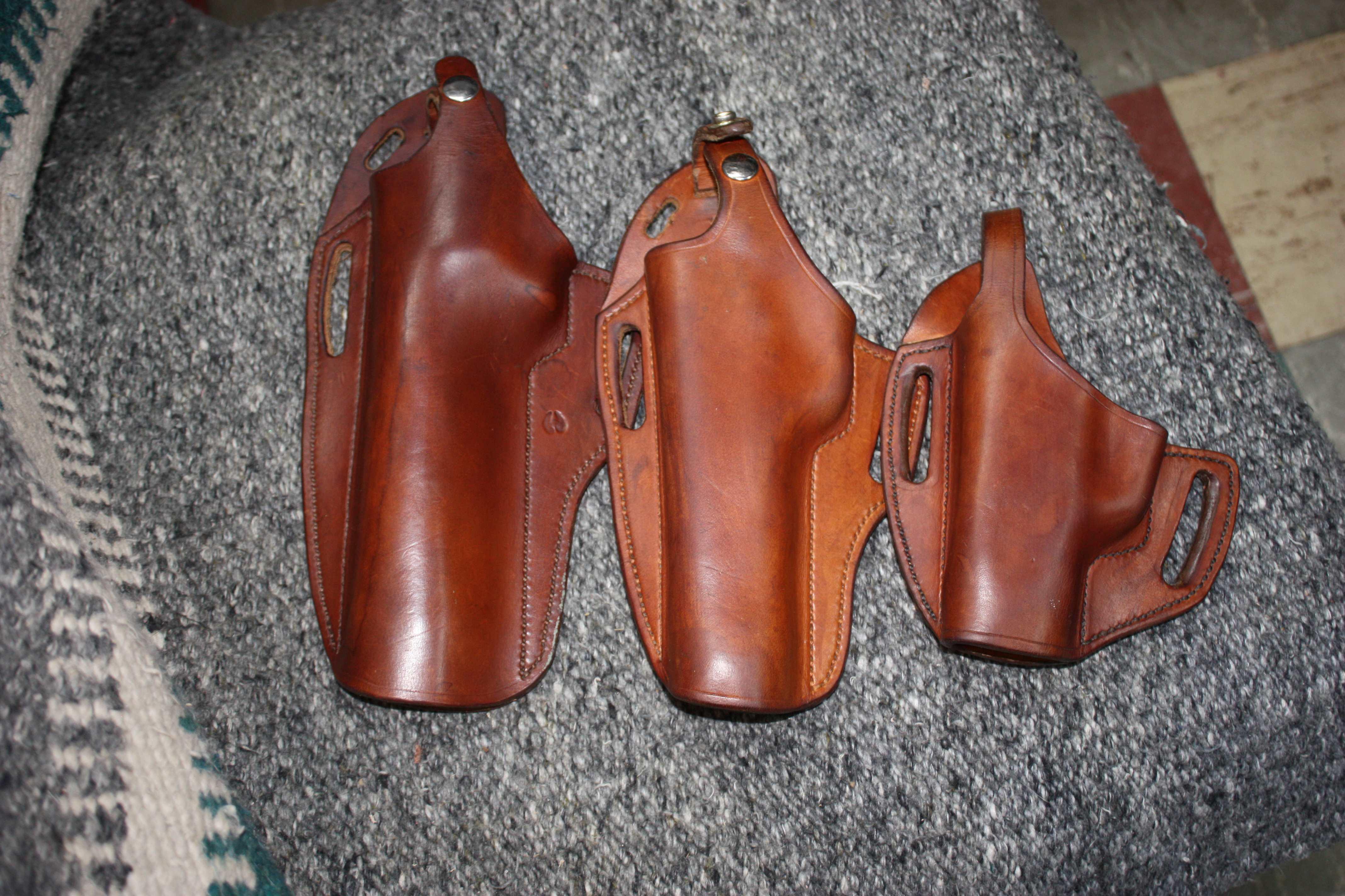

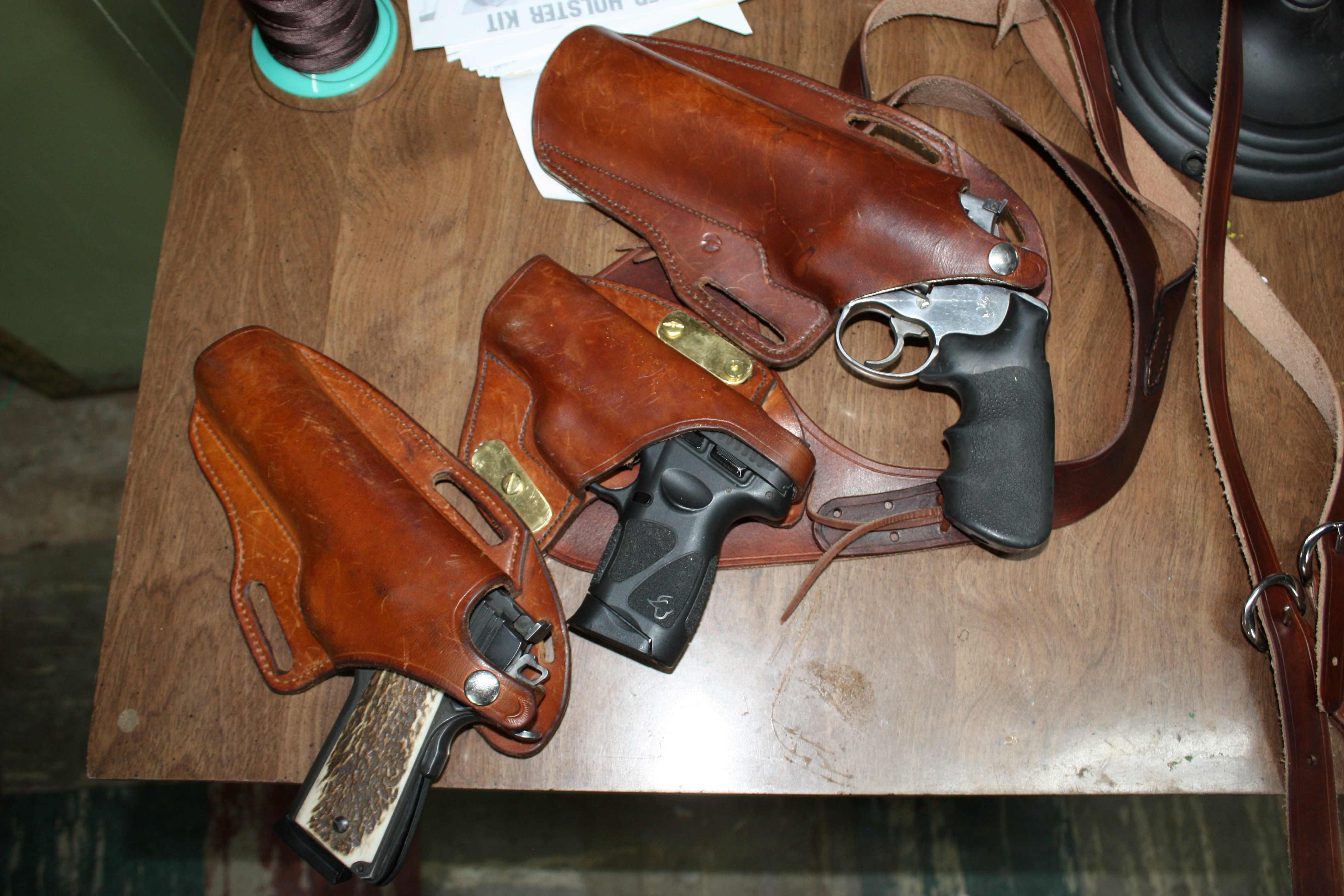

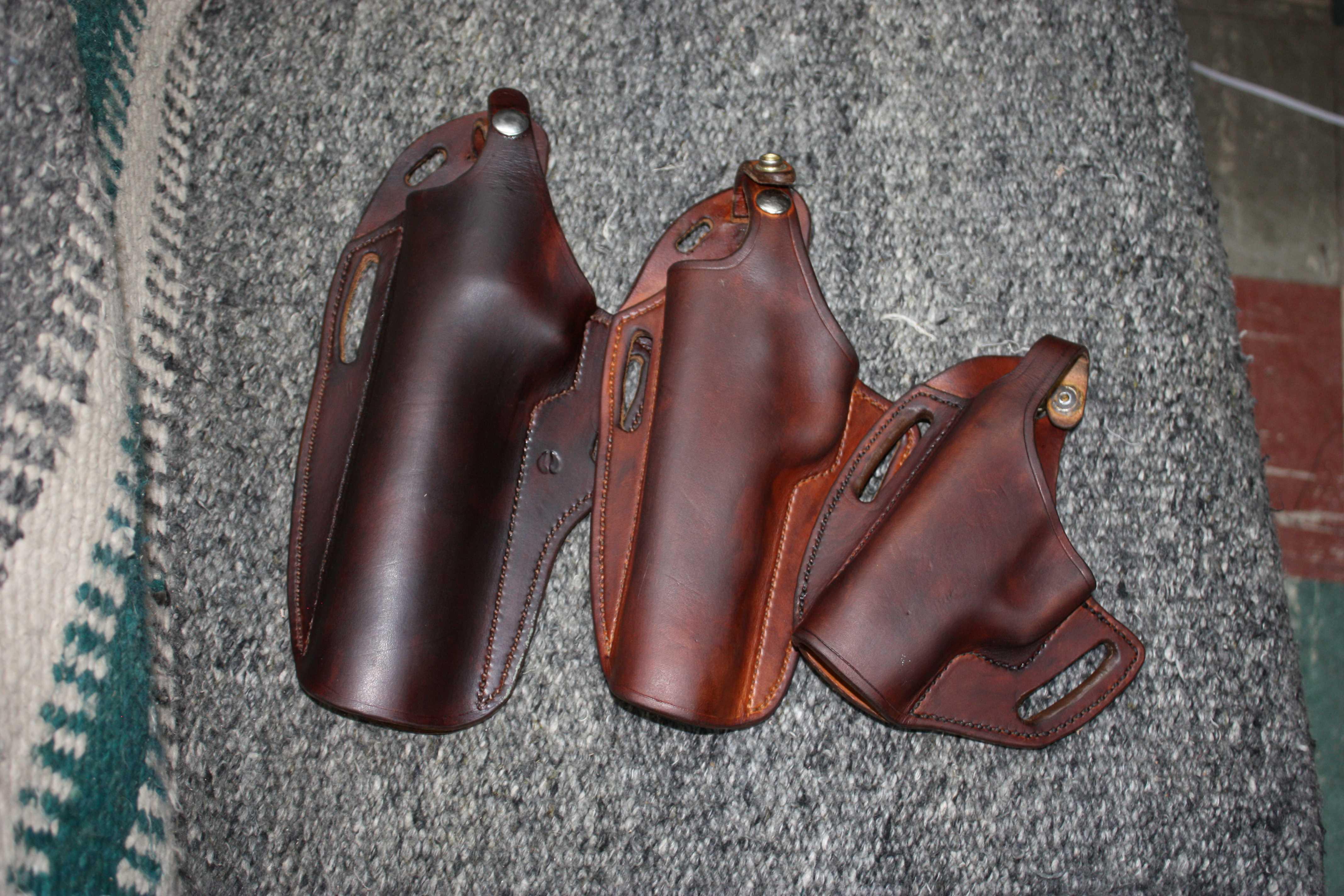

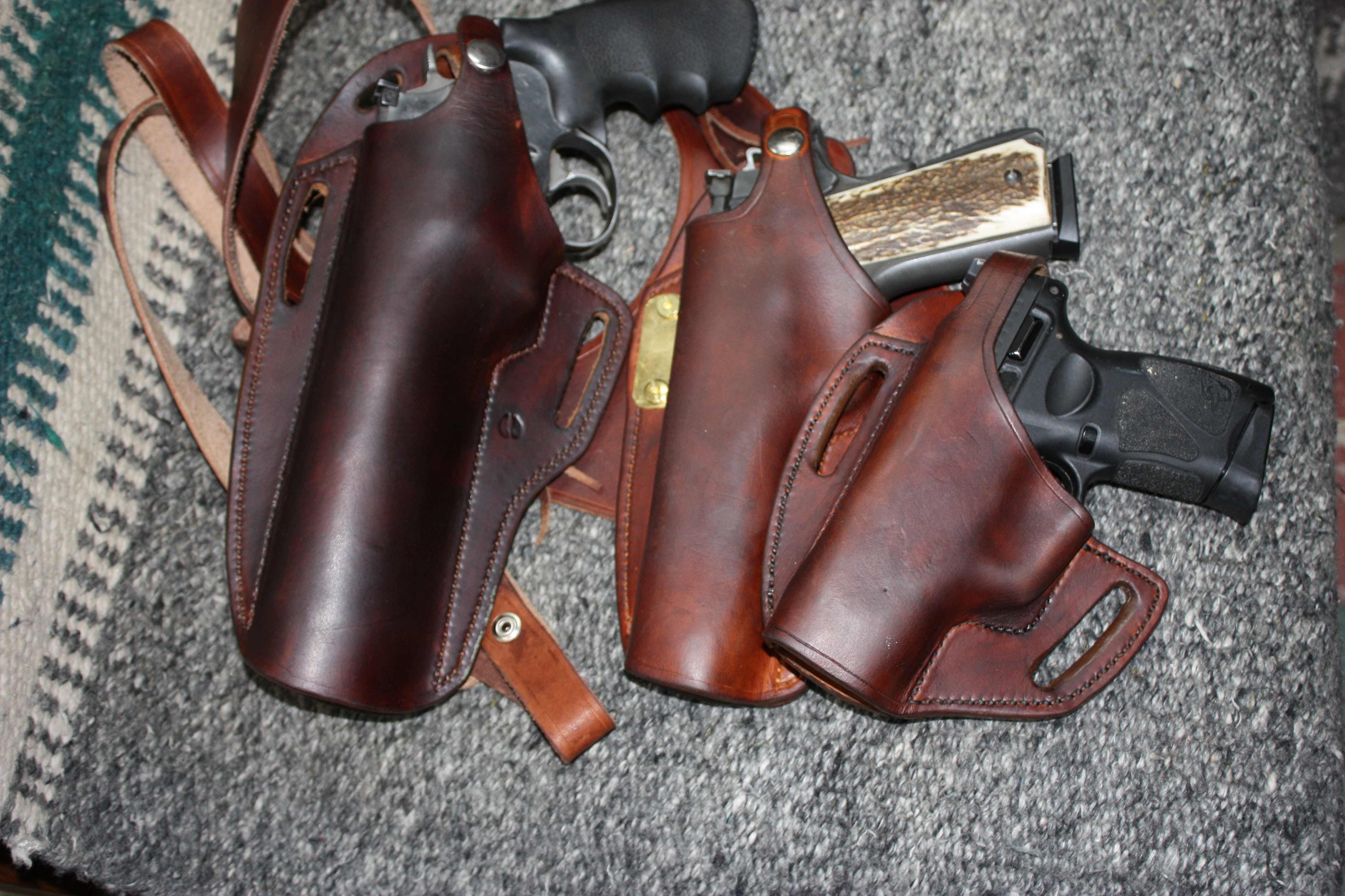

CFM chuck123wapati Posted yesterday at 01:58 PM CFM Report Posted yesterday at 01:58 PM So after posting the other day i realized my holsters looked like a mile of bad road. So first off, i cleanerd em up with a good bit of saddle soap and elbow grease, 2nd picture, then after letting them dry a bit i followed with some golden mink oil, 3rd picture. They will lighten back in a few days. How does everyone else do it??????? Quote Worked in a prison for 30 years if I aint shiny every time I comment its no big deal, I just don't wave pompoms. “I won’t be wronged, I won’t be insulted, and I won’t be laid a hand on. I don’t do these things to other people, and I require the same from them.” THE DUKE!

Members Stetson912 Posted yesterday at 07:05 PM Members Report Posted yesterday at 07:05 PM Oh. I seal mine in acrylic finisher so I dont have to condition them. Matter of fact oil isnt good for the style I build because it softens the leather which can lose retention. But what you did for yours seems OK because of the thumb break. You aren't relying on molding for retention. Quote
Members TonyV Posted yesterday at 07:23 PM Members Report Posted yesterday at 07:23 PM Well-loved and well-used holsters. Simplicity lends well to function and they look like they work exactly as they should. Noice oil work. I bet they appreciate the drink. Quote
CFM chuck123wapati Posted 21 hours ago Author CFM Report Posted 21 hours ago 4 hours ago, Stetson912 said: They used to draw the gun differently in those days. Called a Cavalry draw. The holster was worn as a cross draw freeing up the right hand for the Sabre. The caveat is an odd draw if youre right handed because you have to rotate your wrist 180° to draw the gun. Fun little tide bit im sure you already knew lol You know, some of them also had reins to hold on to when they didn't have their sabre, kinda hard with your left hand too. 5 hours ago, kgg said: Very nicely done. OK, I'll play alone. Being ambidextrous then would be a “double‑correct‑handed”. Ambidextrous really means “right handed on both sides.” kgg 4 hours ago, fredk said: That is a nice clean-up job 30 minutes of work will keep them gooder for a long time thanks they are good for another year. Quote Worked in a prison for 30 years if I aint shiny every time I comment its no big deal, I just don't wave pompoms. “I won’t be wronged, I won’t be insulted, and I won’t be laid a hand on. I don’t do these things to other people, and I require the same from them.” THE DUKE!
CFM chuck123wapati Posted 21 hours ago Author CFM Report Posted 21 hours ago 4 hours ago, Stetson912 said: Oh. I seal mine in acrylic finisher so I dont have to condition them. Matter of fact oil isnt good for the style I build because it softens the leather which can lose retention. But what you did for yours seems OK because of the thumb break. You aren't relying on molding for retention. yeah these aren't city street gun-fighting rigs; they are for hard outdoor use, they get wet, dirty, and abused, so they need a finish that can be maintained. That old flap holster is 50 years old or so, and the flap needs to flex, so it needed a good dose of NFO. Quote Worked in a prison for 30 years if I aint shiny every time I comment its no big deal, I just don't wave pompoms. “I won’t be wronged, I won’t be insulted, and I won’t be laid a hand on. I don’t do these things to other people, and I require the same from them.” THE DUKE!
