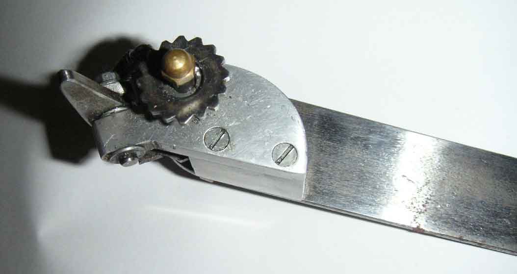

Contributing Member barra Posted March 30, 2008 Contributing Member Report Posted March 30, 2008 (edited) Attached is a Picture of a Plough guage. The wing nut looking screw is to adjust the brass roller for strap thickness and the other adjustment screw is to adjust the width of the strap. It is then pushed to cut straps. Greg is right, have a defibrolator handy when you see the price of a new one. Barra. Edited March 30, 2008 by barra Quote

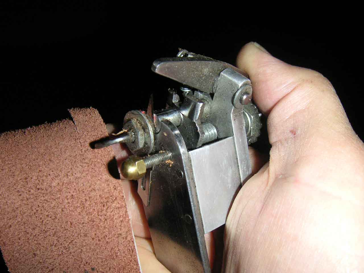

Members daviD A Morris Posted March 30, 2008 Members Report Posted March 30, 2008 Pics of the Dean Williams whip strander. the width adjustment has 2 "stops" on it, one for your narrowest setting, one for your widest. Then as you cut your tapered strand you just automaticaly start at the narrowest (or widest if you want to taper the other direction) that you have set it and gradually work out to your widest setting. Widest that it will cut is about 7/8" Quote
