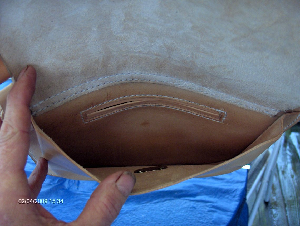

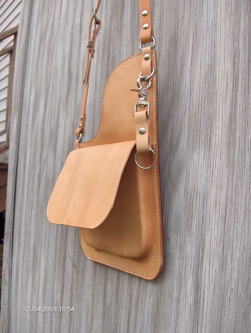

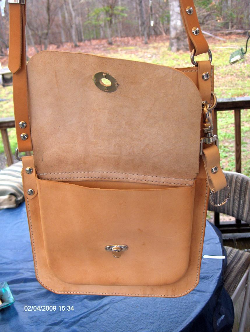

Contributing Member rdb Posted April 2, 2009 Contributing Member Report Posted April 2, 2009 It's raining here, so my usual dodgy picture taking is even worse...lol Just trying something new. I've seen something similar before, but I don't remember much about it...I just liked the shape. I've never seen this type again, so go figger. I think the one I saw had a gusseted front, but since I'm doing a lot of molding lately, I thought that's what I do here. It's slim, that's for sure, but it holds a suprising amount, plus the little inside "vested" pocket. And I added a key ring thingy. The next one, I'll add a cellphone pouch to the top right body, maybe even fit in a pen type pouch somewhere. 2-3 oz leather from Zack White...very clean, and nice to work with. At this point, just neatfooted. Later I'll add some aussies, or snow proof, or some such. I consider this a prototype, so any suggestions are mightily welcome. Quote Web page Facebook

Ambassador Luke Hatley Posted April 2, 2009 Ambassador Report Posted April 2, 2009 I LIKE THE BAG....but... i think the moulding needs to be closer to the stiching. I M OH O . Quote Luke
Contributing Member rdb Posted April 2, 2009 Author Contributing Member Report Posted April 2, 2009 Thanx badger, and Tom. I was tempted to sew tight to the mold line. like in a holster, then realized, by not doing that, the bag stretches out better. My only question will be whether the molding stays mostly intact after long term use. We'll see, I guess. Quote Web page Facebook

Contributing Member rdb Posted April 2, 2009 Author Contributing Member Report Posted April 2, 2009 Thanks Luke, you must have written just as I was, about the stitching. Thanks Steve and Tina. I hope the molding/moulding opens the creative ports....or would that be "pourts"...lol I might be wrong about the weight. It might be a 3-4 oz, seems kind of thick to be 2-3. To mold, I just cut out a 1" board, and rounded the edges...laid down the leather, then tacked it on the outside edges. You can push the basic shape when its fully wet, but the trick is to let it set to dry and leave it for awhile. Come back at intervals to final shaping. Sloppy wet is not the time to bone fold or crease. Hand/finger shape for a time, then as the leather starts to dry out, you can finalize. Quote Web page Facebook
