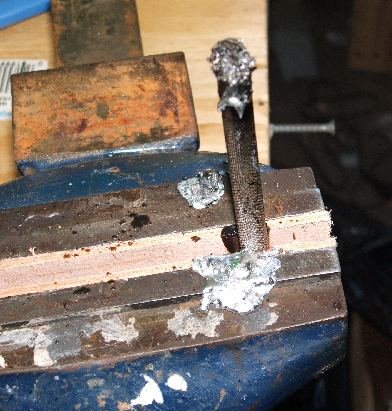

Members Rawhide Posted April 16, 2009 Members Report Posted April 16, 2009 (edited) On one of the other posts were were talking about Tandy tools and the chrome spoiling the impression. Someone mentioned burning off the chrome. My first question is - how do you burn it off? My second question - is that the best way to remove the chrome? Thanks, Art I asked Peter Main this question a while back and he said that he heats them up with a mini torch til cherry red (in a vise of course), and then wire brushes the chrome off, then cool in water. He also said that he doesn't trust the newer craftools to do this with, cause he doesn't know what they are made with. Edited April 16, 2009 by Rawhide Quote Marlon

Members CitizenKate Posted April 16, 2009 Members Report Posted April 16, 2009 just buying better tools is beginning to look cheaper (and safer) all the time.those of you who have removed chrome from the cheaper tools...were the final results worth the effort? ken I've used the propane torch/steel brush method on some Craftools I bought a few years ago (2004 or so). It did improve the clarity of the impression it made, somewhat. The tradeoff is, the underlying metal is quite soft, so heavy use will eventually cause the face of the tool to lose its shape over time. I'll have to replace the ones I removed the chrome from sooner than the ones I didn't. In the long run, it's probably better to leave the plate on. Kate Quote
