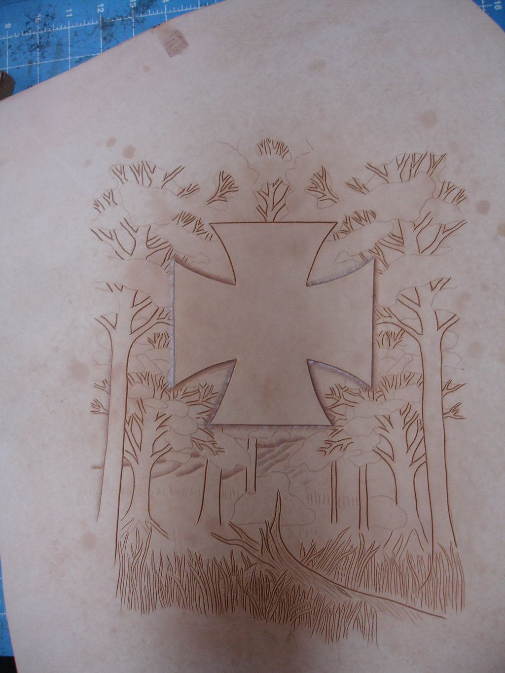

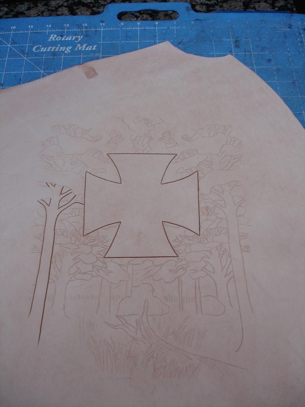

Ok, I know it's been a while since I posted anything but I thought I'd share this one with you...
This is a seat for a buddy. He owns a Tree Service. He's having a custom IronHead Harley built by another buddy so I offered my services as well...
So, Here's a few pics of the project so far... It's going to be all natural colors. Lots of shadowing and shading but no color. I made a play on the "West Coast Choppers" logo and came up with "East Coast TOPPERS". TOPPERS Tree Service is the company's name...
Let me know what ya think!
There is still a LOT of work to be done, but it's off to a good start...

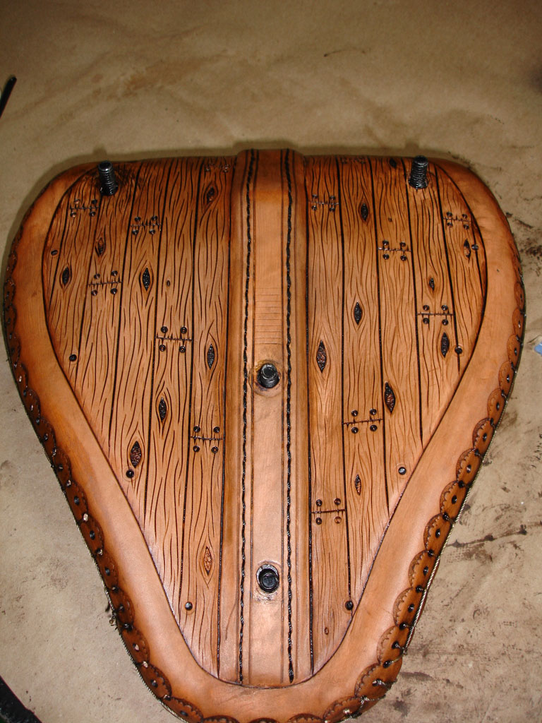

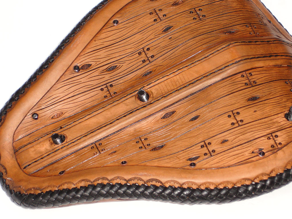

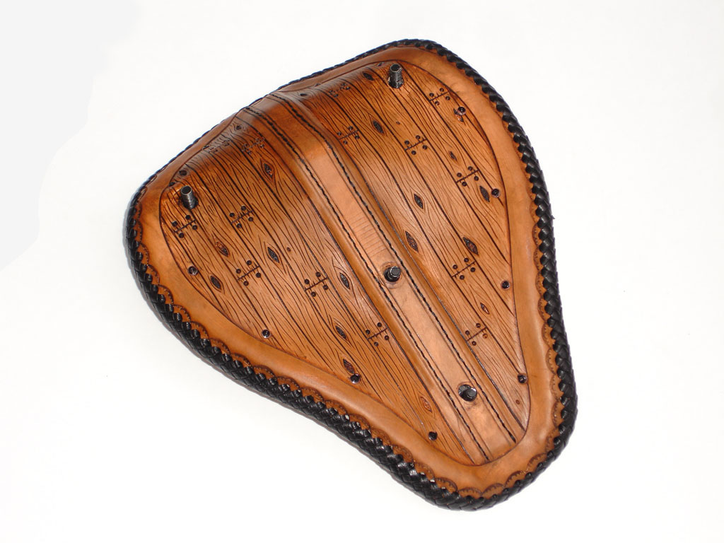

Here's a few more pics... I've been hard at it today too ....
Update:
The bottom is done! All holes have been punched and will be permanently attached today!
The top of the seat is 99% done! All I have to do is add his logo, size it and touch-up the edges once it's sized. Here's a pic of the 99% finished seat top...
If I've overlooked something, please let me know!
Update:

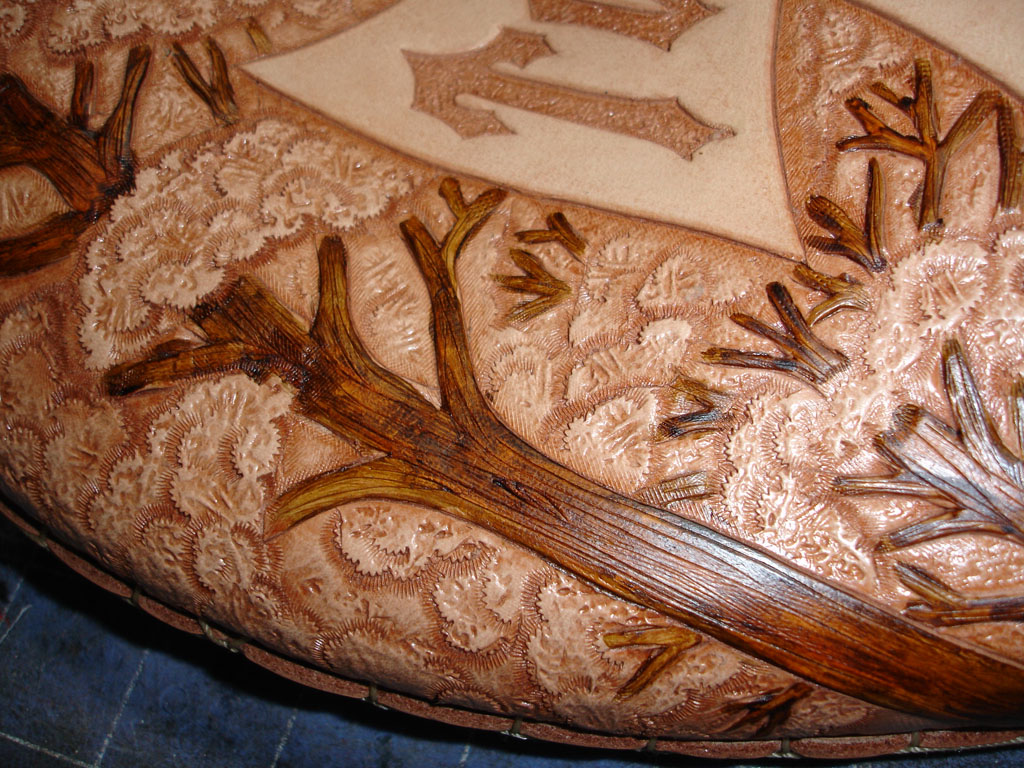

Ok, here's a few pics of the seat top. I've done all of the tooling except for the logo (which I've started) and should be finished today. The seat has been fitted with a 1/2" medical grade Gel Pad by David Scott Company and covered with 1/2" closed cell memory foam.

Here's a few more pics from this morning's work...
That there is a sweet ass seat!! Great design and tooling !
Truly an awsome peice of Artwork! Cant wait to see pics of the finnished seat and pics of it on the bike! Always Love to see the progression of a peice from design to compleetion.
Amazing master craftsman quality work, wow! That you did the bottom of the seat too shows the care you take in making something truly marvelous. Bravo!

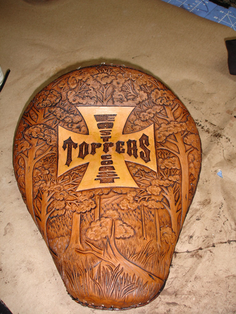

I had a slight problem during the finishing stage... I applied 2 coats of BlockOut to the Iron Cross. Just the cross, not the letters in the cross. I wanted the cross to POP! It turned out like it was supposed to. Then I applied 2 coats of Tan-Kote to the entire seat and let it dry overnight. It looked great. The customer saw it and decided he wanted the tree trunks to be a shade or two darker to resemble real trees. I applied a coat of TAN Gel Antique to give it that rustic look, let it dry a few hours then went back to buff it off. Here's where the :censored2: problems start! The Tan-Kote blocked so much of the color that the tree trunks looked orange. So I diluted some Briar Brown Hi-Lite stain and rubbed the whole seat to add a very light shade of hi-light to the cut lines and texture, but all of a sudden, the whole :censored2: seat turned Pecan Shell Brown!
Personally, the seat color looks awesome! It was a totally unexpected color, but, it does look great! I know every piece of leather is different and accepts color differently, but this is first time the leather ever turned so DARK so fast! I planned on the Tan-Kote blocking most of the color and just allowing a little bit to set in.
My only real concern is the customer liked the seat natural colored but wanted the trunks a shade darker. All I can do is give him this seat, and if he complains about the color, I'll do it for him again.
Any thoughts??
Okie Dokie! All finished...
:whatdoyouthink:
Looks good Troy,
That was an ambitious project. Lots of tooling nice job. I would probably have taken one look at the back of that pan and said "No thanks"
Keep up the good work.
Dave Theobald
Thanks Dave!
Your opinion is VERY valued to me! I look at your work and aspire to be that good one day! Now I just need to find that custom bike shop that wants me to make their seats!
Thanks again for the compliments!
Troy
