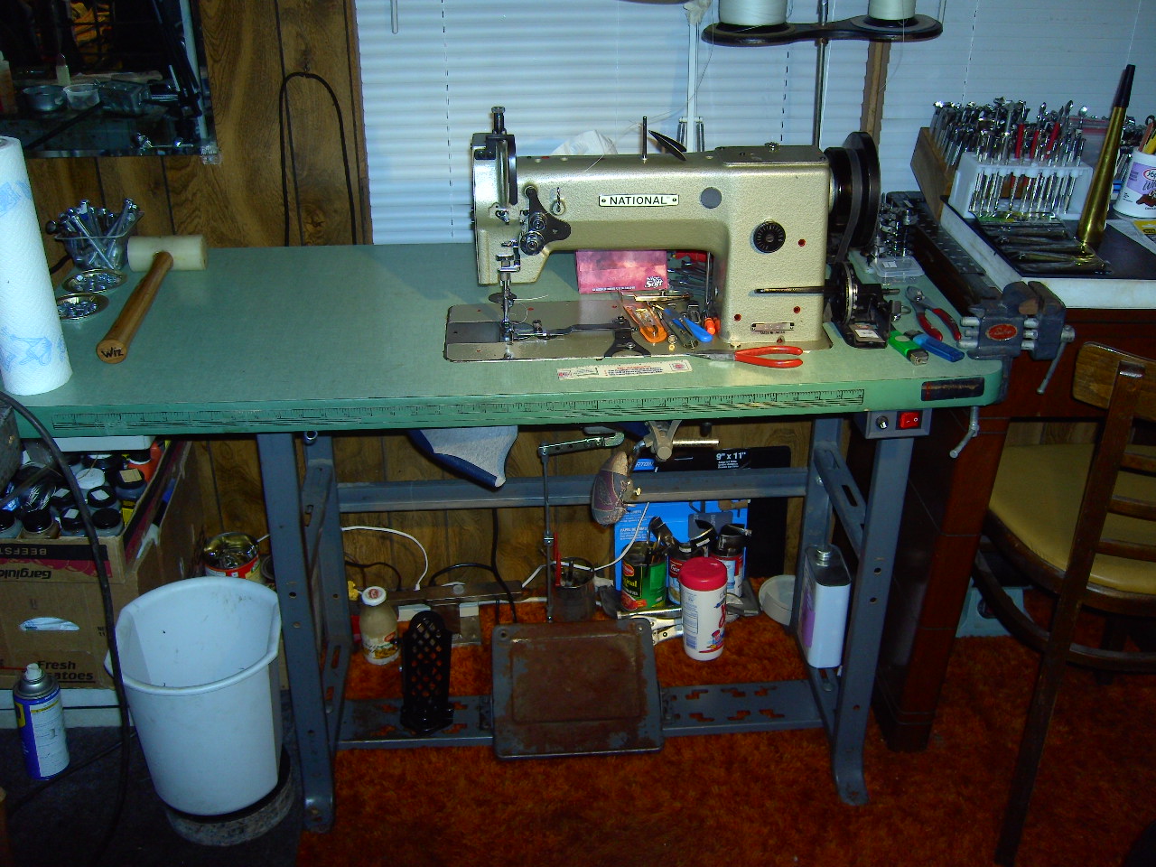

What you need is called a walking foot machine. These are full size, 70+ pound industrial sewing machines, mounted on 20" x 48" x 1.75" tables on steel legs, with a large 1/2 hp clutch or servo motor mounted to the underside of the table. A V belt connects the small pulley on the motor to a large pulley on a flywheel, on the back of the machine head. The speed is controlled by a large foot plate that pivots on a steel bar running along the front of the k-legs assembly. There is also a knee lever under the table, or second foot pedal on the floor bar, to raise the pressor foot without using your hands to do so.
There are two pressor feet on a walking foot machine; a forward/backward moving narrow inner foot with a hole for the needle to go through, and a larger up/down motion outer foot that secures the material or releases it. There is usually a lower feed dog with one row of teeth, that raise and lower as it moves through slots in a throat cover plate. As the bottom feed dog moves backward the needle and inner pressor foot are timed to move with it by the same amount. While the inner foot, needle and feed dog are moving the material, the outside pressor foot is lifted off the material. Because the feed dog, needle and inner foot all move the material simultaneously, from top to bottom, the stitch length does not vary, because the layers don't drag against the top foot. Also, because of this compound feed system, multiple layers stay aligned on a walking foot machine.
In comparison, on a standard straight stitch machine all of the feeding is done by the feed dog teeth dragging the material from the bottom, while the single flat pressor foot maintains top pressure to prevent the material from lifting as the needle and thread come out of the material. If one loosens the pressor foot tension too much, to allow sticky material to feed without dragging, the material may lift as the needle begins to lift up, causing skipped stitches. The material must stay all the way down as the needle exits it, in order to form the loop that gets pulled around the bobbin case by the pickup point. Often, when sewing leather, you must apply so much top pressure, to avoid skipped stitches, that the drag of the pressor foot cause the stitches to vary in length, or causing the top layer to go out of alignment with the bottom layer of material.

Below, are a couple of pictures of my National walking foot machine. It is capable of sewing just over 3/8" of belt leather, with up to #207 nylon thread, using a # 24 needle. It is equipped with a left toe only pressor foot set, in these photos. I have about 10 different pressor foot sets for this machine, to do various types of jobs. Parts costs are very reasonable on these types of machines.
