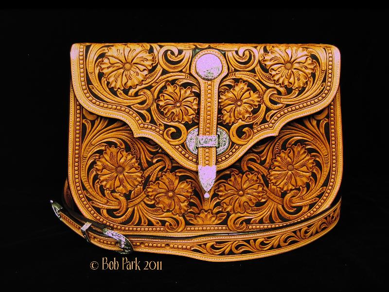

hidepounder Posted January 20, 2011 Report Posted January 20, 2011 Here is a project recently finished for the gear show in Elko. Made of 5/6 oz Hermann Oak and lined with 2/3 oz. Panels and bottom of gusset all have 4 mil styrene stiffeners.Shoulder strap lining, gusset exterior and interior lining all are finger carved. Sewn with 69 nylon thread. Sterling silver is from Silver King in CA . All critiques welcomed as always. Quote

Members Shelly Posted January 20, 2011 Members Report Posted January 20, 2011 Hi Bob - Beautiful work, as always - just when we think you have reached the top, you surpass yourself!! I do have a few questions - you mentioned that you used #69 nylon thread - what machine are you sewing it on - only the interior, or all parts, including the outside panels? How many stitches per inch? I would love to make a trip to AZ and come learn something from you! Wish I still lived there sometimes...I was raised in the Phoenix area, and moved to NM in 1986, then to OK for 3 years, in 1995, now in Mineral Wells, since 1998....this area reminds me more of AZ than any other, just don't have the saguaros, barrel cacti, etc - we do have some cactus. Lots more humidity, so that's the trade-off for having grass! Thanks! Shelly Quote
DaveJohnson Posted January 20, 2011 Report Posted January 20, 2011 Great piece Bob - agree with all the previous comments on the quality, detail and inspirational value - the swivel knife detail is to be envied !! But I can hear you saying "it comes with hours and hours of practice" !! Thank you for sharing and inspiring once again. Just one question - with the dyed and burnished top front panel edge in contact with the natural inner lining of the flap, do you get a coloration line on the inside of the flap over time, or is there a way of sealing and preventing this ? Cheers Dave Quote

Contributing Member Crystal Posted January 21, 2011 Contributing Member Report Posted January 21, 2011 Another goregeous bag! And I believe I see the buckle holes on the "spot". Oh, I dream of doing work this nice. Crystal Quote

Chief31794 Posted January 21, 2011 Report Posted January 21, 2011 I don't understand this at all Bob, I carve just like you, swivel knife in right hand, stamps in left with maul in right, but yet the end result isn't quite the same by like about a million miles. This is some of the best work I've ever seen and I've been to the Stohlman Museum. I know people might think this is sacrilage but to me I think your work is head and shoulders above anyone else including Al Stohlman's. Absolutely beautiful!!!! I've never seen anyone as good with a swivel knife as you. Ken Quote

Ambassador pete Posted January 21, 2011 Ambassador Report Posted January 21, 2011 (edited) Beautiful work as always! Question- if you don't mind. What kind (color, wt. brand) of leather do you use for this project? I have a whole slew of oils that I need as the leathers all have some differences. The last batch was so "white" that I had to use my old reliable neats+chocolate dye mix after tooling just to give it some color. And is that med. brown paste? Also- did you use a double beader to make the tracks on each side of the beads, or do you cut the lines , bevel, and use a single beader. Thanks for the great work. You are an inspiration! pete Edited January 21, 2011 by pete Quote

Members BIGGUNDOCTOR Posted January 24, 2011 Members Report Posted January 24, 2011 Beautiful work, even though I have never been a huge fan of this style of carving. It is usually too busy for my taste, but you make it look good. How long does it take you to make something like this? The swivel knife work reminds me of the engravings done on guns, or automotive pinstriping. I had not seen this technique until joining this forum. It adds a nice touch to the piece. How does it hold up to wear, and tear from use? Does it open up any, or collect goobers like dust, etc? Quote

hidepounder Posted February 1, 2011 Author Report Posted February 1, 2011 Beautiful work, even though I have never been a huge fan of this style of carving. It is usually too busy for my taste, but you make it look good. How long does it take you to make something like this? The swivel knife work reminds me of the engravings done on guns, or automotive pinstriping. I had not seen this technique until joining this forum. It adds a nice touch to the piece. How does it hold up to wear, and tear from use? Does it open up any, or collect goobers like dust, etc? I don't want to say how many hours I have in this because it's embarrassing, LOL! I can tell you however that making the interiors on these items is very slow because I skive and turn every single edge by hand and line every piece. The finger cutting holds up very well and will collect a little dust as all carving does. Thanks for your comments. Bobby Quote
