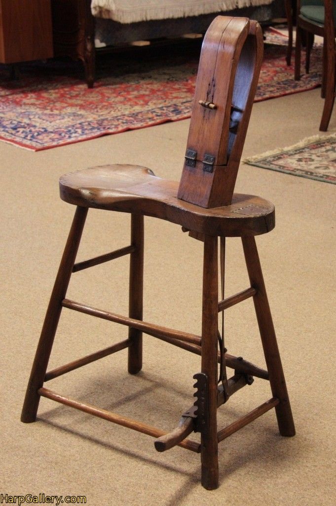

Surfing the web and found these pics I think it was at an antique sales site quite expensive if memory serves. I got some plans from Billy P. which I am going to build as soon as I can find a 14'" bandsaw I can afford.

i have a similar horse that my dad built a good 20 years ago.
i had him make me some larger jaws like the one in the pic but not off set.
you can make the jaws by laminating them.
i'm gonna try and see if i can get him to make me a draw down horse. i'ed really like to have the added depth in the jaws as sewing up these bags is a bit of a challenge.
this horse is all pine and when he made the new jaws, he used poplar where they meet.

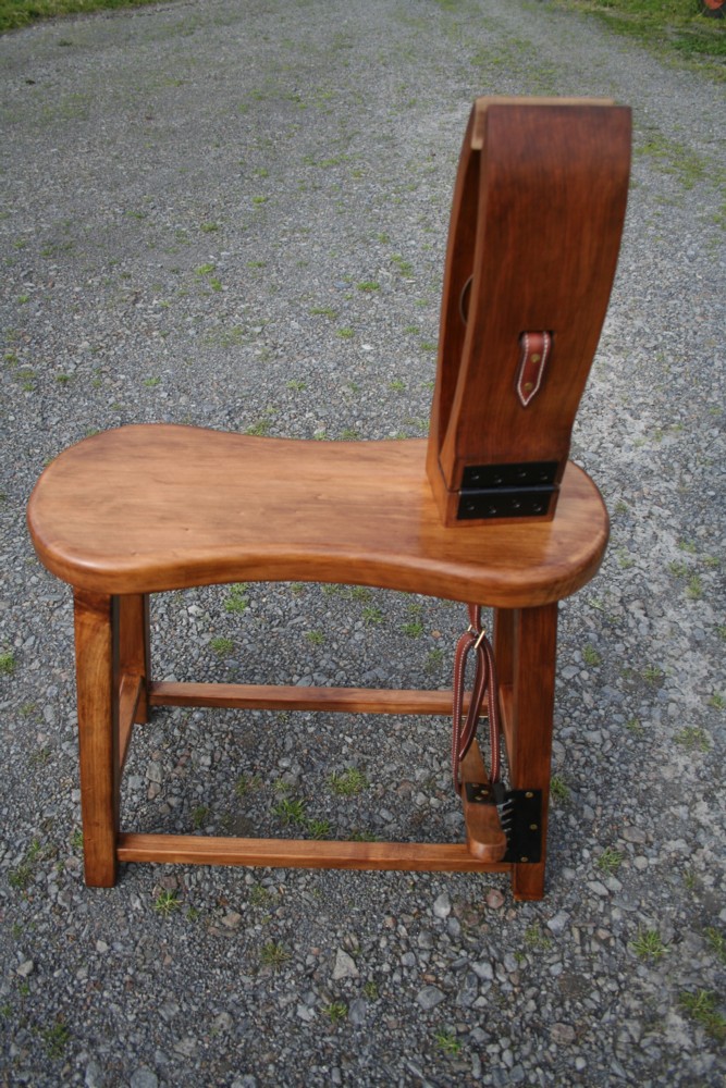

stitching_horse.jpgHi Jordan
I found some similar photos on an Antique Sale site last year. Fortunately the shop had the presence of mind to include the dimensions of the Stitching Horse as well. Armed with all this info I trotted off to a Joiner friend - who is quite used to me turning up with unusual requests but I think this one took the cake! After much muttering into his beard he turned up with the wooden bits. My Husband made the brass swivel for the foot pedal and the ratchet etc. A spring was "borrowed" from an old seat out of our 1935 Dodge and I made up the belt. The timber is New Zealand Kauri, the jaws are made from Norfolk Pine. I applied two coats of Danish oil and beeswax. The timber work cost around $600NZ - alot less than getting an antique shipped here! It has just about paid for itself already and is a great talking point in the workshop.
Best wishes with your wood work
DJ

Hello Jordan
I have that exact stitching horse so if you need a tracing of the jaws when you get ready to build let me know. The jaws in mine are made from "Hard Rock Maple" and the seat or bench is oak. I have seen the same pattern with the bench made of pine.
Another Saddle maker duplicated mine years ago and found the wood at an architecture wood supply house rather than a conventional lumber yard or supply house.
Blake
