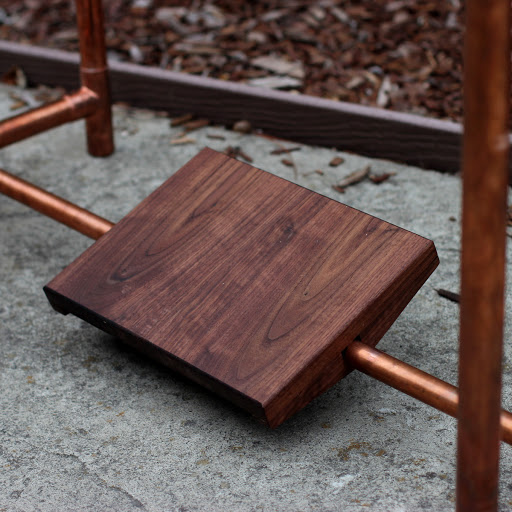

Members thesergeant Posted July 24, 2015 Author Members Report Posted July 24, 2015 Copper legged table is finished! I ended up adding a cross brace to the back and it added quite a bit of stability, thank you for the suggestions to do that! I'm probably going to drill and rivet some of the joints/tubes in place for some additional security as well.The top of the table is going to be walnut so I made a matching walnut foot pedal that is removable. I'm still thinking about the best method to attach the table top. I'll update the thread when I figure it out.The legs feel plenty strong with no real noticeable flex or give but they just don't have the heft of the steel legged table that I made previously. I picked up an o/a welding setup last week and am planning on make matching steel/walnut tables for the rest of our machines. This one is probably going to be the only copper legged setup and will be for a lighter duty machine, maybe our Bernina 950 or possibly our Bernina 217. Quote
Uwe Posted July 26, 2015 Report Posted July 26, 2015 Nice work on the copper table frame, Mr. Sergeant! I like the walnut pedal, too - it looks very classy. Quote Uwe (pronounced "OOH-vuh" ) Links: Videos
