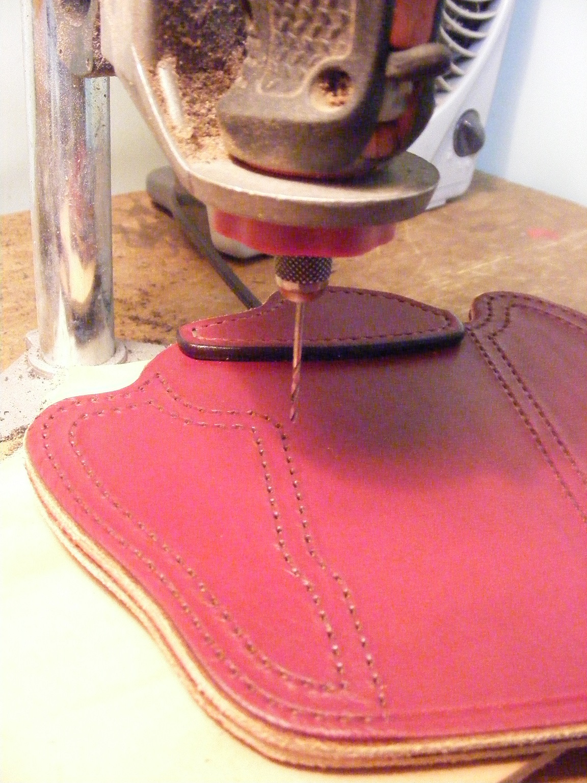

Members jbossartcustomgunleather Posted July 23, 2013 Members Report Posted July 23, 2013 For years I have use a dremel in a drill press. My holes are just large enough to accomodate my needles with out drag. I do this because I have two torn rotator cuffs, along with carpal tunnel and chronic back pain, I just can't handle strenuous sewing. Forunately I picked up my first sewing machine today, smooth running and beautiful stitches- goodbye dremel! Quote
Members harley45 Posted July 24, 2013 Author Members Report Posted July 24, 2013 I'm interested in the dremel method as I have hand issues also, care to share more info? Quote
Members jbossartcustomgunleather Posted July 24, 2013 Members Report Posted July 24, 2013 I use a black and decker with a knock off press rig, and a set of dremel brand bits and collets, but you can buy dremel brand in both, Make sure your dremel has the threaded end for attaching to the press. I use maine thread company waxed polycord in the smallest size, and very small blunt needles(I have used tapestry needles from the local walmart and stoned the tips in the past, lol) This process works for flat work, I cement my holster halves, sand the edges, do the lay out work, and drill. Then re tool the stich lines with the overstitch wheel and sew. I use as amall of a drill bit as possible that will still allow the needle and thread to pass through with little resistance. You can experiment with different hole/needle sizes to find a comfortable setup. I've done this for years with excellent results. Hope this helps Quote
