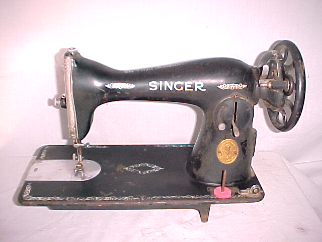

So I'm new to the forum and i was just wanting to post some questions about a machine I'm looking at purchasing, and don't want to make a purchase ill regret.
The Singer 201 Treadle machine is the one I've had my eye on, I'm from New Zealand so its not to often you come across a nice one, but i seem to have found one, just wanting to know from some more experienced leather workers if this machine would be suitable for leather sewing, nothing to heavy duty but just wallets and accessories with 4-5oz natural vegetable tanned leather.

Those are great machines,but they are better when you sew what they were designed for.Clothes with regular thin thread.If you want a heavy duty type of home machine get a Singer 15 class they have a type of hook in them that will allow you to use #69 nylon & sew 1/4" or so of leather w/o any problems.The 201 has a rotary hook that is for lightweight only.The 201 is a very smooth & sought after machine here in the states for quilters,it seems like there wasn't as many made as the 15 class.

Thanks alot cowboybob that helped alot, I'm still abit ignorant towards the specifics but are you talking about a singer 15k? Is that a treadle machine? How so I know if it has the hook your talking about, there are quite a few machines availible but there details are not listed, how does this machine your talking about look like? Thanks again!
Ok,what you need to look for is to make sure the bobbin goes in underneath from the left side instead of from the top like the 201 .

.... are you talking about a singer 15k? Is that a treadle machine? How so I know if it has the hook your talking about, there are quite a few machines availible but there details are not listed, how does this machine your talking about look like?
Look at your photo closely, and you'll see that the upper tension is on the front facing the operator. On a Model 15, it's around on the left end. That's probably the most obvious difference that you can pick out in a photo. The Model 201 and the Model 15 both can be a treadle, but also can be electric gear-driven (201-2 & 15-91), or electric belt-driven, or hand cranks. A 15-(dash) and a 15K with the same sub-numbers (example: 15K88 & 15-88) will be the same machine, it's just that the dash ones were made in America and the K ones were made in Brittan. You'll probably see more K machines in your area.
The 201 has a drop-in horizontal Class 66 bobbin, and the bobbin case is usually only removed for servicing.
The 15K has a vertical Class 15 bobbin, and the bobbin case is removed each time that the bobbin is removed.
