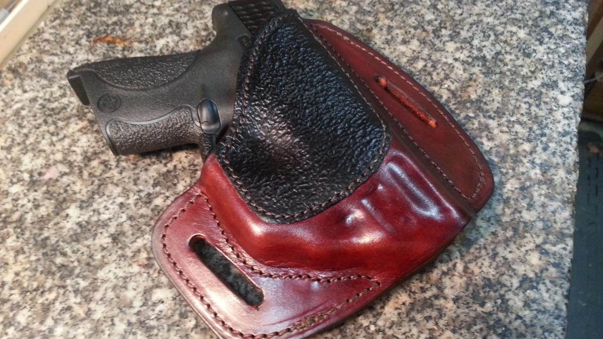

Members Dwight Posted November 12, 2013 Members Report Posted November 12, 2013 (edited) For the new belt loop postition, I'm leaning towards about 1/2-3/4" higher. Does this seem like enough? The ideal placement for maximum stability is low, . . . just enough opening between the belt top and the grip front to get your fingers to get a really good hold onto the grip of the weapon. And when you cut your belt slots, . . . do not be generous. They need to fit the belt with no real sloppiness, . . . loosen enough to slide on, . . . but tight enough not to move afterwards. From some reading, retention straps seem to be a personal preference. I like the idea of no strap/snap, but would like to hear more ideas. What happends to this style of holster over the long haul? Will it loosen up quite bit to where it may be needed? I counsel against retention if it is an IWB, . . . belt and body pressure should make it so it won't cough up and out, . . . along with proper molding. For a pancake, . . . sometimes (some LEO depts mandate them) they are needed, . . . if I put one on, . . . 99% of them are thumb breaks. I did all the forming on the front piece, and the back leather is just flat. It that ok? Is some forming of the rear piece important? It seems more comfortable flat than a friends that has some forming of the back piece. A pancake properly molded will not be uncomfortable when worn as an OWB, . . . all my IWB pancakes and the vast majority of my other IWB holsters have a flat back as a comfort aid. I probably won't be building a belt any time soon, but I am looking into some before the next holster build. Not having a proper belt, . . . it's like trying to figure out what these new style tires will look like on my car, . . . without first having rims to fit them. Take a time out and build a basic belt, . . . glue two 7 oz pieces together, . . . punch some holes, . . . put on a buckle, . . . dye and finish it, . . . even if you don't sew it (following katsass directions for proper Weldwood application) you'll have something that will give you a real good idea of where you really need to go with the holster. May God bless, Dwight Edited November 12, 2013 by Dwight Quote If you can breathe, . . . thank God. If you can read, . . . thank a teacher. If you are reading this in English, . . . thank a veteran. www.dwightsgunleather.com

Members bugboy449 Posted November 12, 2013 Members Report Posted November 12, 2013 Cave, I'm new at this also and what I do sometimes is draw my belt on the pattern paper and then mess with the gun to find the center of gravity of the gun. I like the balance point of the gun to be somewhere on the belt line. It can be at the top of the belt line but I usually shoot for the middle. Quote
Members Red Cent Posted November 12, 2013 Members Report Posted November 12, 2013 I would suggest the belt never goes below the trigger guard's lowest horizontal line. Quote https://www.facebook.com/redcentcustomleather?ref=bookmarks http://www.redcentcustomleather.com/
Members Jumpout Posted November 13, 2013 Members Report Posted November 13, 2013 I agree with Red Cent. The rear slot on your holster is too low. Find the balance point of the pistol you are working with. It will be different without the loaded magazine in the gun. Be extremely cautious and ensure there is not a round in the chamber then find your balance. Because you have that extra weight in the grip of the pistol when you put the belt loop as low as you did on that holster, probably 80% of the weight of the gun is above the belt line and it will definitely flop. Like Kat said, the holster can only do so much for concealed carry with the primary goal being a secure rig and fast access to the weapon when needed. You have to dress around your method of carry. Quote
Members malabar Posted November 13, 2013 Members Report Posted November 13, 2013 You can certainly make high-ride holsters -- most of mine ride a good 3/4-1-inch higher than the average pancake -- but you must design the holster so that t has the structural strength to ride up there without "bouncing." For example, the back on my high-ride pancake holster is laminated out of two layers of (fairly thick) leather. That gives the holster the stiffness it needs to ride high, like this... http://www.malabargunleather.com/holsters/high-ride BTW: It sure looks like you have a lot of forward cant on the pistol. That's kind of counterproductive for the vertical draw technique that is taught at most places today. tk Quote
