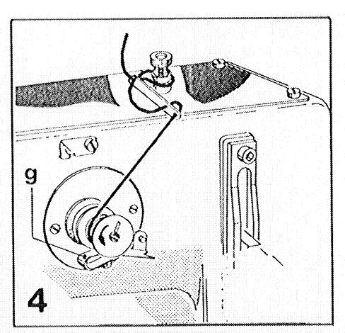

Uwe Posted September 29, 2015 Report Posted September 29, 2015 (edited) The detail highlighted in your photo looks like it's only used for winding the bobbin and is not in the thread path for normal sewing. I think the description right above from chikitti is the closest to what Adler intended, based on this diagram I found in a 267-373 manual using the same tension device in a different location (and turned around). The tension device in this diagram IS used for sewing. Yours looks very much like the exact same device, just in a different spot and turnaround. Perhaps this diagram helps: I hesitate to even mention this video below about 267 bobbin winding because it kinda shows how NOT to do it, even though he manages to wind a bobbin. The fellow runs that poor machine at full speed with the presser feet just slamming metal to metal - that has got be wrong! At least lift the presser feet up so they don't make contact. He also does not use the threading path intended for the device - but it works for him perhaps because of the larger disks. Edited September 29, 2015 by Uwe Quote Uwe (pronounced "OOH-vuh" ) Links: Videos
