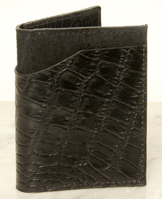

Members biglew Posted May 18, 2014 Members Report Posted May 18, 2014 well I am working on being a better leather craftsman... I just finished this one Quote
