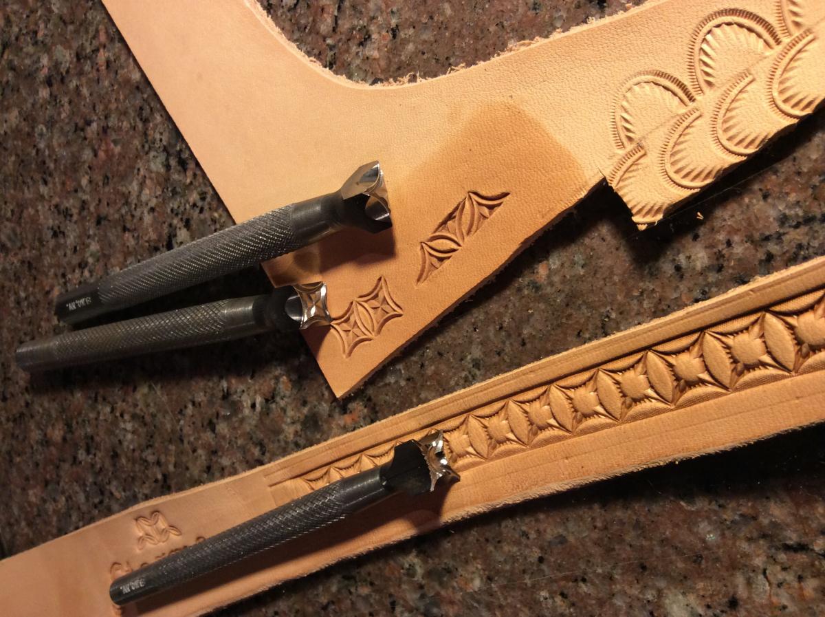

LNLeather Posted July 10, 2014 Report Posted July 10, 2014 (edited) I Love this place and how everyone is so willing to share - problems and possible solutions. This will remind me to try a sample corner... So Thanks for that! BTW - since I mentioned that etsy notebook (with Basket Stamp and Decorative Border Design) would it be terrible of me to ask a question about that? I spent quite a bit of time trying to figure out how you did that outer border... searching/looking at different distributors/stamps - trying to find a way to do that my self. I found a 3 point snow flake? stamp that is similar to your design but I could not find one with only 2 points or a similar triangular stamp to the one you used on either side of the snowflakes? - soo there is No way I could duplicate your "beautiful/perfect border" on that notebook. I just love that border and don't recall seeing that design anywhere else. If you do mind sharing your secret to that or if this is not the proper place to ask.... since it kind of hijacks the subject of this "Ladies Clutch Wallet" post - I would totally understand. (I looked at your gallery and other pic's in posts to see if there was a better place to ask this question) Edited July 10, 2014 by LNLeather Quote
Contributing Member Bob Blea Posted July 10, 2014 Author Contributing Member Report Posted July 10, 2014 (edited) No problem Cheryl. This isn't the exact stamp I used but it's just like it. The one on the top is what makes the border and there is a sample of its impressions below it. It's half of a square geometric made by Wayne Jueschke in Elko, NV. the full size version is shown right next to it. IMO he makes the best geometric and basket weave stamps out there.I'm not at home so I couldn't take a picture of the exact stamp but this one is close and it's the same size. Wayne intended them to fill a stamped area when you just need half a stamp but they make a great border! That's what use them for. Edited July 10, 2014 by Bob Blea Quote

LNLeather Posted July 11, 2014 Report Posted July 11, 2014 Thanks so much for sharing that info. I just love how that border looks, so I guess I"ll have to talk to Wayne Jueschke and get those stamps... I'll probably send a pic of your stamped border on the notebook... Soo cool! Thanks again Bob, for all of your help. Quote
