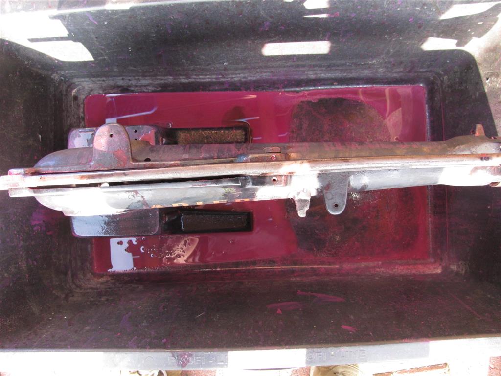

Sunny afternoon today and I took the chance to wash down the pink hippie paint from the head and it worked great! It took me just 45 minutes to remove it.

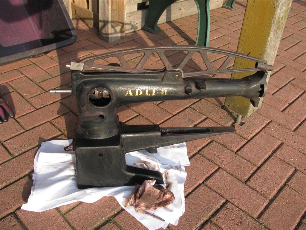

The machine turned out quite nice - not much rust or sticky oil on the parts just the gear box cover has some surface rust. I hope this thing will sew when I´m done.

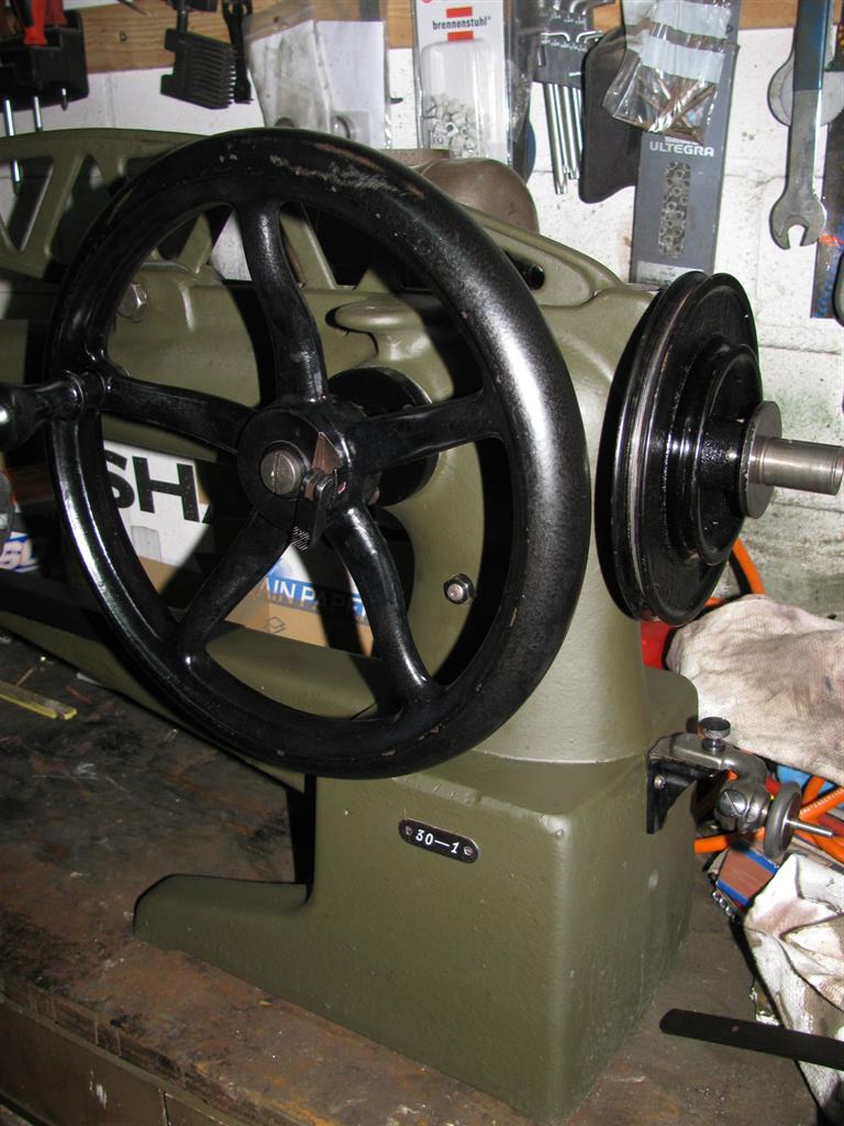

Some progress...
I decided to paint it Olive Drab (a whole different thing but I like it), I have blued the gear box with Gun Blue and I have highlighted the lettering with white paint. I ran out of OD paint so the head will be painted and assembled in the days to come... As you can see - no rust on the head parts and yet I have only used paint thinner to clean them. I hope it will make some nice stitches. I was not able to test it as it was covered and gummed up with pink hippie paint. So it´s a bit of a gamble this time.

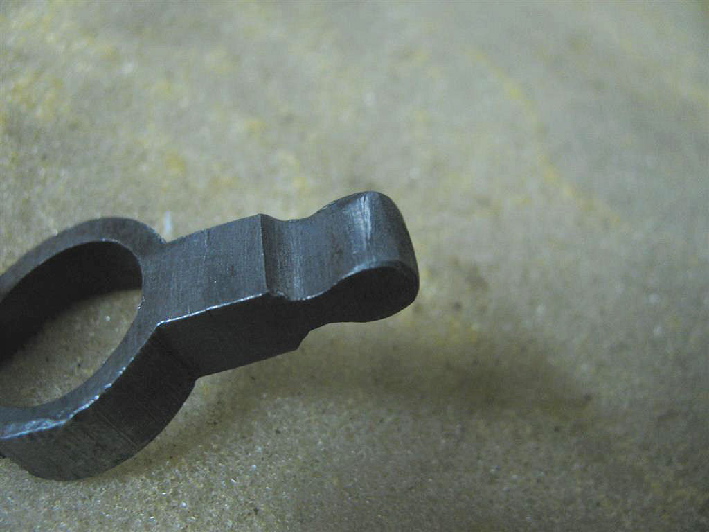

Cleaned up very nice. The long rack looks to be in good shape. How much wear is there on the bellcrack lobes? Great find.
glenn
Excellent,
Lobes look great. I think you may be selling the Singer 29K73 before long.

Just painted the rest, assembled the head and put everything else together - runs very well so far. I haven´t timed it yet but is makes 4.5mm - 5mm stitches in cardboard. Pretty good result. If I had no other patcher I´d keep it but my Singer runs a bit smoother and is more compact.
Olive Drab is not everybody's cup of tea but I think it is quite nice.

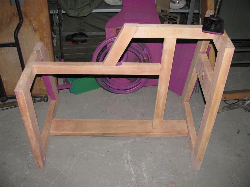

Next challenge will be the treadle stand. I think I have to fully disassemble it and grind off the paint.

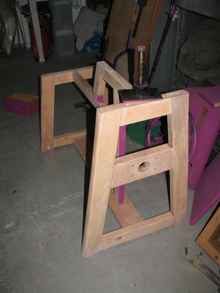

Some progress on the wooden treadle stand but still enough pink to sand down :wacko:
I think I will motorize it and take off the treadle mechanism but I´m not sure yet.
