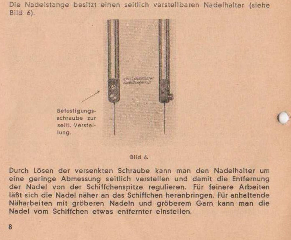

Evo160K Posted November 4, 2014 Author Report Posted November 4, 2014 (edited) Shoepatcher, here are some pics. Does anyone know what the sliding piece with the wing screw fastener in the attached picture is for and how do you know when to use it? Constabulary, how's your German? Textima, the maker of the Textima/Claes machines sent me a set of operators instructions written in German for a machine, Model R P X, which they say came just prior to and is very similar to my 8345-30. Most of it I recognize, but there is a page I can't translate well enough with google translate to make sense. Edited November 4, 2014 by Evo160K Quote

Members Constabulary Posted November 4, 2014 Members Report Posted November 4, 2014 Here is an enigma for you, Constabulary. Tell me if you know what film this is from: "Hier ist die Nadel." Translate it for our English speaking friends. Wiz, I´d assume you are referring to the Movie "The Eye Of The Needle" but it is decades old and I haven´t seen it very often but I think I remember Donald Sutherland is "The Needle" as he used to kill his opponents with a needle like stiletto. Right? Constabulary, how's your German? Textima, the maker of the Textima/Claes machines sent me a set of operators instructions written in German for a machine, Model R P X, which they say came just prior to and is very similar to my 8345-30. Most of it I recognize, but there is a page I can't translate well enough with google translate to make sense. Ah well, not to bad I think as I`am German Let me know what you need translated and I´m trying my best. Depending how long the text is it could take a couple of days. Quote ~ Keep "OLD CAST IRON" alive - it´s worth it ~ Machines in use: - Singer 111G156 - Singer 307G2 - Singer 29K71 - Singer 212G141 - Singer 45D91 - Singer 132K6 - Singer 108W20 - Singer 51WSV2 - Singer 143W2
