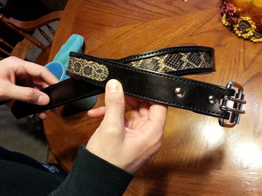

Members mike6642 Posted November 13, 2014 Members Report Posted November 13, 2014 HI, first nice work , I could have wrote that post, like you I just started making belts and with all the great help that I received from members from this forum has made making belts a lot of fun. here is a couple belts I just finished for my friends and relatives. Quote
