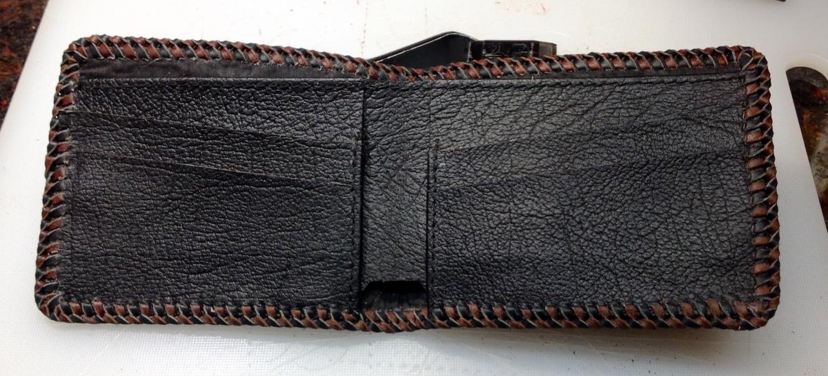

Basic wallet made from elephant I was happy to get from a forum member in Africa. Inside is pig with an interior pattern I like to use. Two tone Kangeroo laced.

Hi Aaron,
Great to see what you have done with so little elephant....
I like the colouring you did to the original - it looks good!
Looks awesome! I love the two tone lacing!
Chan Geer would be impressed with the Two Toned lacing. Great job.
Bob Stelmack
Thanks guys. For the color I used brown Fiebings. I had a friend comment that he thought that elephant would be gray, not brown. I get a lot of positive comments on the two tone lace. I like it a lot better than basic double loop. Chan was the first person to teach it to me. I am grateful to him for all he has taught me.

Nice! And the two-tone lacing really brings out how close the lace work is.
Personally I hate the spider leg look from narrow lace and holes punched too far apart. 1/8 inch lace, 3/32 inch slits punched 1/8 inch from the edge works well. The double lace fills in the spaces even better. A lot of the time even if I am only using one color I will still use two laces.
