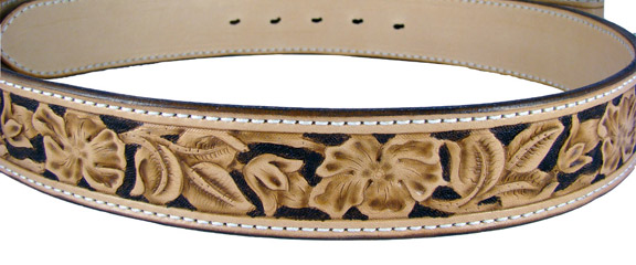

Members KBCustom Posted January 30, 2015 Members Report Posted January 30, 2015 Hello Everyone, I am brand new to the site, but have been working with leather for quite a few years now. I am 100% self taught, so many of my techniques could use refining. My current problem/question involve carving techniques. I have been noticing that while im in the middle of beveling and backgrounding a piece, parts of my leather ( where i have made cuts) starts to get very brittle and almost takes on an undercut look to it. I have tried applying a leather conditioner, but it seems to give me issues when i go to stain my piece. I have included pictures of examples to help explain my question as well. I need to figure out how to make my work look more crisp and refined. Any criticism is greatly appreciated. Thanks KB Custom leather Quote

Members Troy Burch Posted January 30, 2015 Members Report Posted January 30, 2015 I was taught to cut about a 1/3 into the leather. I had similar problems years ago when I started carving. Your moisture content is not right, to dry or to wet will cause you to see the cut lines after beveling. How deep are you cutting your leather? The pic seems to show alot of cut lines after you have beveled, I don't think you need to cut deeper because the cuts are still there, maybe you didn't bevel all the way to the bottom of your cuts. Quote
Members KBCustom Posted January 30, 2015 Author Members Report Posted January 30, 2015 I have been cutting about halfway through the leather. I try to tool my leather when it feels slightly damp to the touch. I generally wI'll try a small spot and if it isn't burnishing really well in that area I will come back to it. Is this piece destroyed or is there something I can do to save it? Since I made my cuts so deep, my bevelling is pretty deep as well I don't want to punch through the leather as I have in certain other spots since I like tooling deep. Quote
Members Troy Burch Posted January 30, 2015 Members Report Posted January 30, 2015 You don't have to cut deep to have plenty of depth in the tooling. The beveler will bevel deeper than your cuts if the moisture is right. If you've cut thru the leather with your beveling before your probly cutting too deep. I don't know of any way to fix it, but if it's ruined anyway properly case it and try to rebevel. If I were you I'd get some scrap and cut different depths and see which works best. Quote

Members camano ridge Posted January 31, 2015 Members Report Posted January 31, 2015 (edited) KB what is your method for casing? A lot of people make the mistake of wiping a little water on the surface let it start to dry if it turning back toward natural color and feels cool you are ready to carve. not necassarily so. It takes more then moisture on the surface. If yo have not already done so read Hidepounders thread on casing leather http://leatherworker.net/forum/index.php?showtopic=19121 There are other ways of casing leather the important thing is to get the corect moisture content throughout the leather not just on the surface. Edited January 31, 2015 by camano ridge Quote https://www.facebook.com/CamanoRidgeCustomLeather?fref=ts
Members KBCustom Posted January 31, 2015 Author Members Report Posted January 31, 2015 I generally spray the piece down with water, then I wait a while testing every so often until I can start tooling the area. Quote
terrymac Posted January 31, 2015 Report Posted January 31, 2015 Appears to me to be the a moisture issue. The deepest part of your cut should also burning the darkest when beveled. Camino is probably right in that your moisture is not deep enough. Terry Quote
Members KBCustom Posted January 31, 2015 Author Members Report Posted January 31, 2015 I just read through the casing method. Very interesting. I want to see if I'm understanding it completely. Pre-tooling, I should wet the piece and place it in a bag or airtight container then come back to it in a day? From then on, after I start tooling, i need to keep the parts I am not tooling yet, covered. Would it also help to cover the areas I have tooled so it doesn't get wet or handled too often as well? Quote
Members Troy Burch Posted January 31, 2015 Members Report Posted January 31, 2015 Wet the leather then let it dry back to almost normal color, then put in a bag in the fridge overnight. This will make the moisture content even thruout the leather not just wet on top. The way you were wetting your leather the beveler cant do its job on the middle and bottom where its too dry. uncover just enough at a time that you can tool that area before it loses its moisture. no need to recover what you've finished tooling. do the decorative cuts and back grounding last as they need less moisture. Quote
Members Tina Posted January 31, 2015 Members Report Posted January 31, 2015 (edited) The pictures looks exactly like a patience and casing problem. You have to wet the leather enough but also WAIT long enough to start the beveling. 1. Let the cased leather sit overnight in a bag. 2.Take out and then let "dry" until the surface looks and feels dry...Very important! 3. NOW is the time to start your work. These steps should take away your problems :-) Edited January 31, 2015 by Tina Quote "He who works with his hands is a laborer. He who works with his hands, and his head is a craftsman. He who works with his hands, and his head, and his heart, is An Artist" http://vildkorpens-laderlya.deviantart.com http://tupali.deviantart.com/
