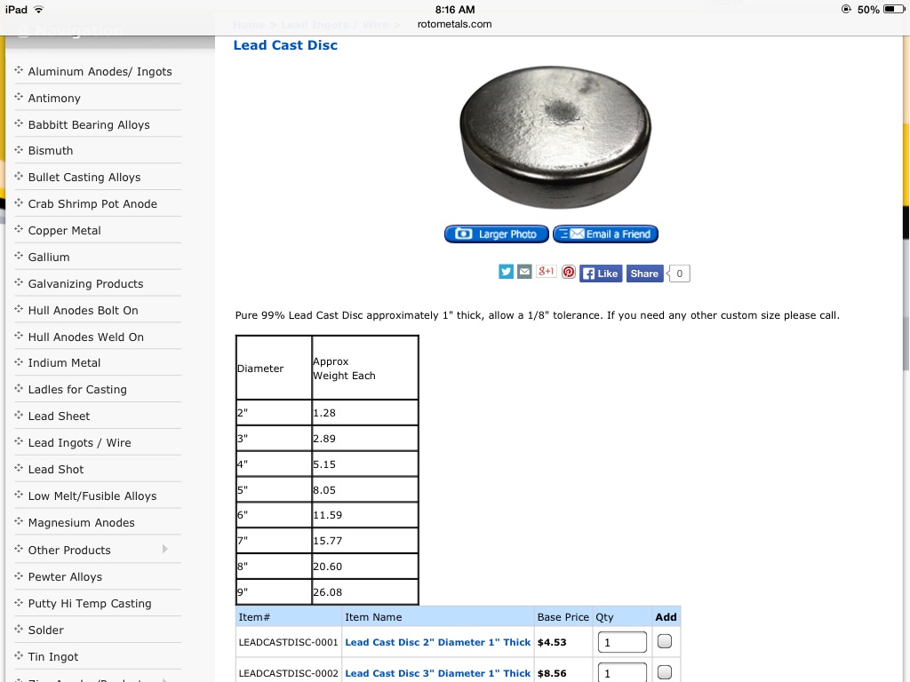

Members Tugadude Posted May 2, 2015 Members Report Posted May 2, 2015 (edited) Just for grins I looked up sources for lead online and found the attached information. Cheaper than I thought, less than $32.00 for a 6" diameter x 1" thick disc. Of course you have to pay shipping and it is heavy as lead! Edited May 2, 2015 by Tugadude Quote
