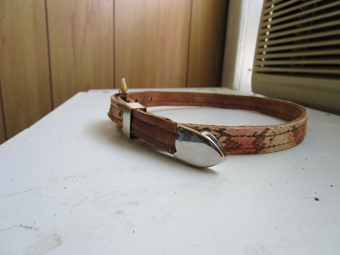

Members DoubleC Posted July 21, 2015 Members Report Posted July 21, 2015 Mat, these watch bands intrigued me so I made my dog a collar using the same technique. It's not as good as the examples you showed because for one I couldn't cut the ends flush and have it flip. I needed he extra weight. Don't know how well it will hold up but very proud of it right now, looks great on my dog. Quote http://www.etsy.com/shop/DoubleCCowgirl
Members Wild Bill46 Posted July 26, 2015 Members Report Posted July 26, 2015 This dog collar is interesting, sure enough ! Nice work Cheryl ! Quote
