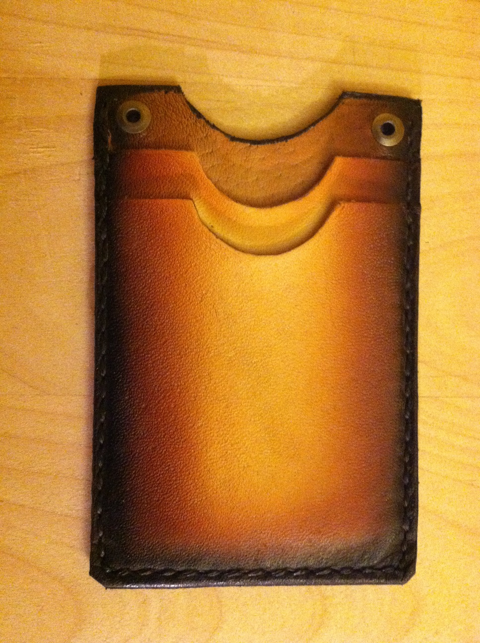

Members Colt W Knight Posted August 25, 2015 Author Members Report Posted August 25, 2015 I haven't had any trouble spraying full strength Fiebings leather dye. I will try to do a video and show how I do a sunburst finish. Quote

Members Colt W Knight Posted September 7, 2015 Author Members Report Posted September 7, 2015 I use a syringe and a 2 inch needle. Best way I have found so far. Quote

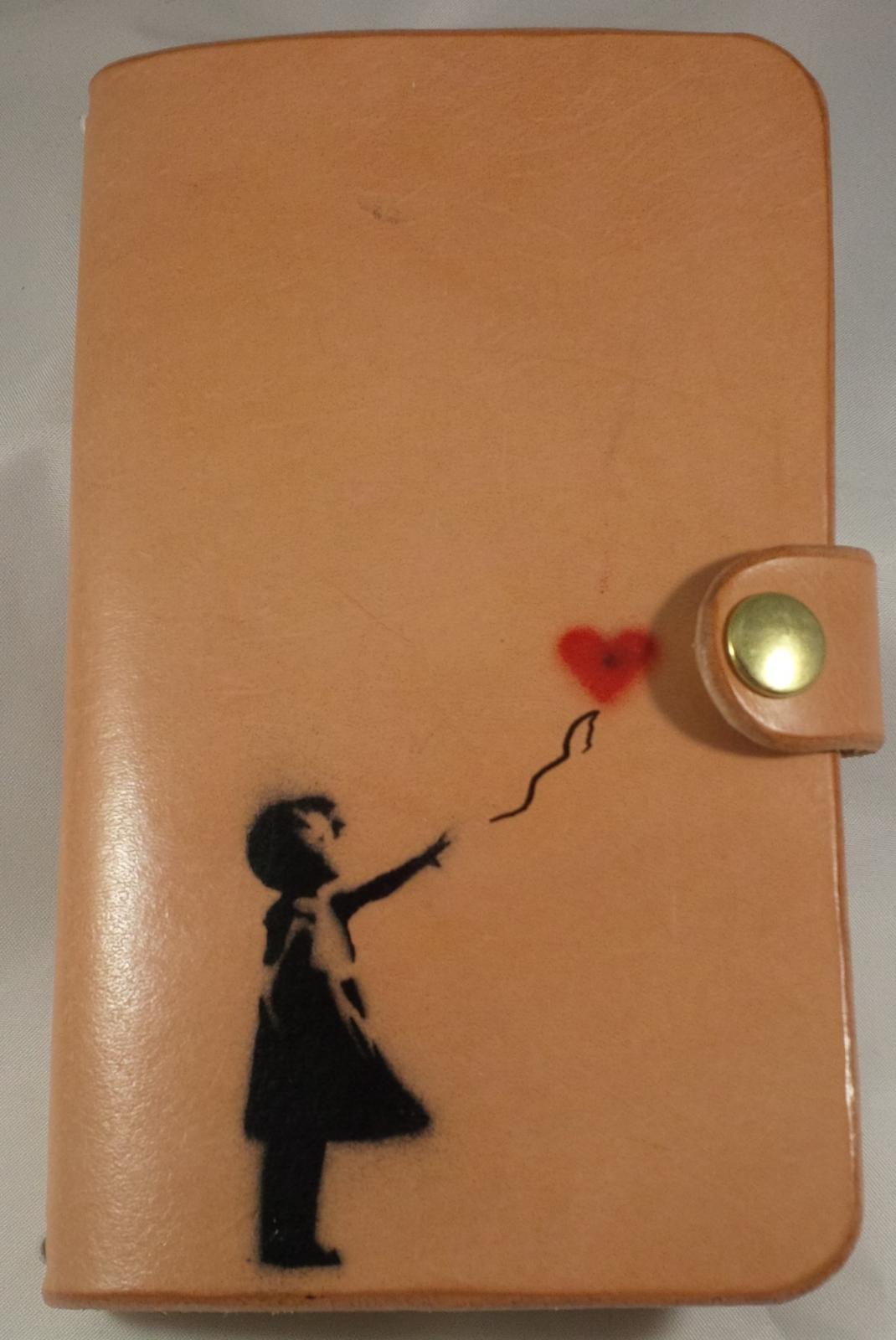

Members Seamus76 Posted September 10, 2015 Members Report Posted September 10, 2015 Thanks for the thread. I was looking at HF brushes and had seen some bad reviews, but I think I'll give them a try. Especially given I won't really use it much. I was able to pull this first attempt off, only using a small Preval disposable sprayer from Home Depot. The stencil was cut by hand from a sheet of paper. Not bad I thought. Quote
Members Colt W Knight Posted September 10, 2015 Author Members Report Posted September 10, 2015 I've used prevails before, an airbrush, even a hf cheapie, is way better in my honest opinion. Quote
Members Seamus76 Posted September 10, 2015 Members Report Posted September 10, 2015 I've used prevails before, an airbrush, even a hf cheapie, is way better in my honest opinion. Oh I have no doubt. It was just laying around and I figured I'd give it a shot, but yeah you're right, I can imagine even the cheapest airbrush is better than that. Quote
