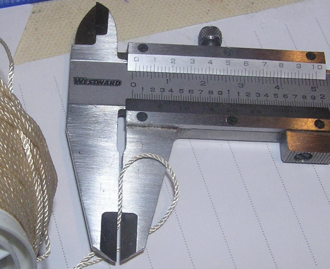

Members DrmCa Posted August 21, 2015 Members Report Posted August 21, 2015 (edited) From what I could find on the web, it must be slightly over size 400, but I am not sure which size exactly. 415? Or is it actually a 0.9mm thread in size 400? It is hard to measure correctly as the caliper would compress it. Would that be a proper thread for the holsters? And the machine part of the question: the specifications for Juki 441 say it takes up to size 28 needle. Do the clones take size 28? I looked at Tecksew 5100 and it says size 27. Is it a 441 clone and will size 27 needle work with 415 thread? Picture is of the thread I am talking about. It is 3 strand non-bonded nylon sold for saddle and harness repair. Edited August 21, 2015 by DrmCa Quote Machines: Mitsubishi DB-130 single needle, Kansai Special RX-9803/UTC coverstitch, Union Special 56300F chainstitch, Pfaff 335-17 cylinder arm walking foot, Bonis Type A fur machine, Huji 43-6 patcher, Singer 99 hand cranked, Juki DDL-553 single needle (for sale)
