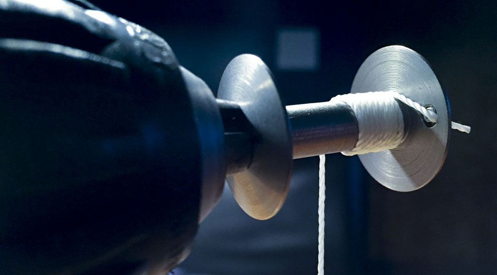

I had used a hand drill and made little bobbin hooks to wind bobbins. That worked quite nicely to make perfectly wound bobbins, but it was a pain to hold the drill steady and reverse it if the thread reversed direction before it reached the edge of the bobbin. I had seen commercial motorized bobbin winders for the small bobbins and thin thread, but never one for the big shuttle hook style bobbin. So I decided to make one just because, well, SEWING!
Here are some pictures of my little bobbin hook that I used with my hand drill for a while:

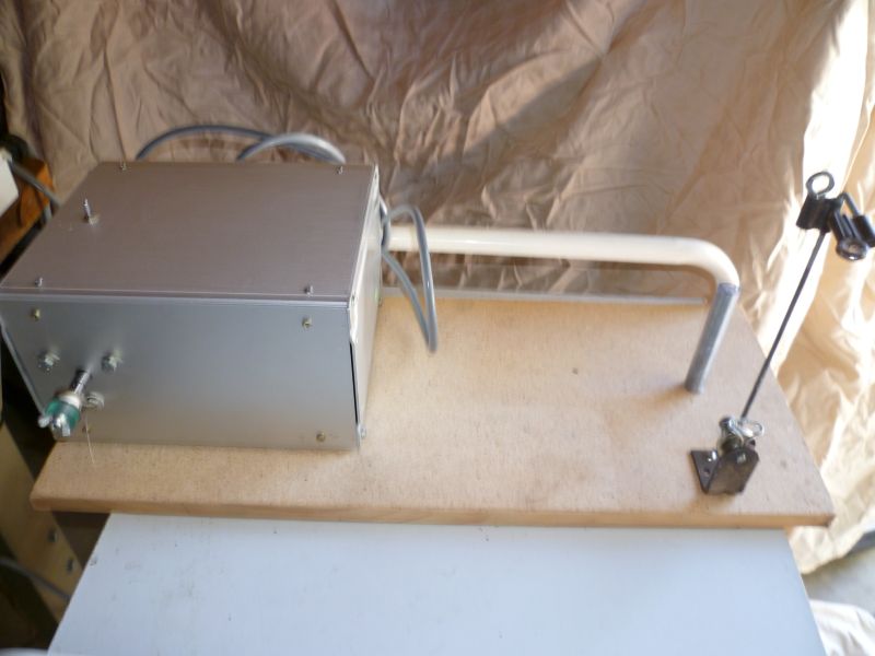

I've been keeping it secret, I may have also solved this problem. Variable speed and 11 seconds per bobbin. More to come...But i will blow my horn in my own thread. For now, 1 crappy iphone3 photo is all you get. Fully aware it will not work set up as it is in the photo.

That's what's known as a teaser, TT. I, for one, look forward to some details?
In the meantime this is the initial device that I cobbled together (it lacks the finish of Uwe's, mainly because I wanted to see if it would work first). Which it does, but it's slower than Uwe's. To speed it up would require using a pulley converter on the output shaft, which seems to defeat the purpose of gearing the motor down in the first place, or removing the gearbox completely, which then creates more problems as the gearbox housing is the actual mounting point for the motor assembly.
While it winds ok, if using #69 thread it would take a while to wind, which means I'll need to fit a cut-off switch so that it stops when wound (then it would be a "set and forget" device). I reckon a micro-switch, set so that the arm trips when the bobbin is full (like the mechanical arm on a normal winder) should work.
I do have some smaller 24v motors, but they are high speed and may not have the torque when running slow. More experimenting, I suppose. But at the moment I now have a slow speed, high torque winder.
