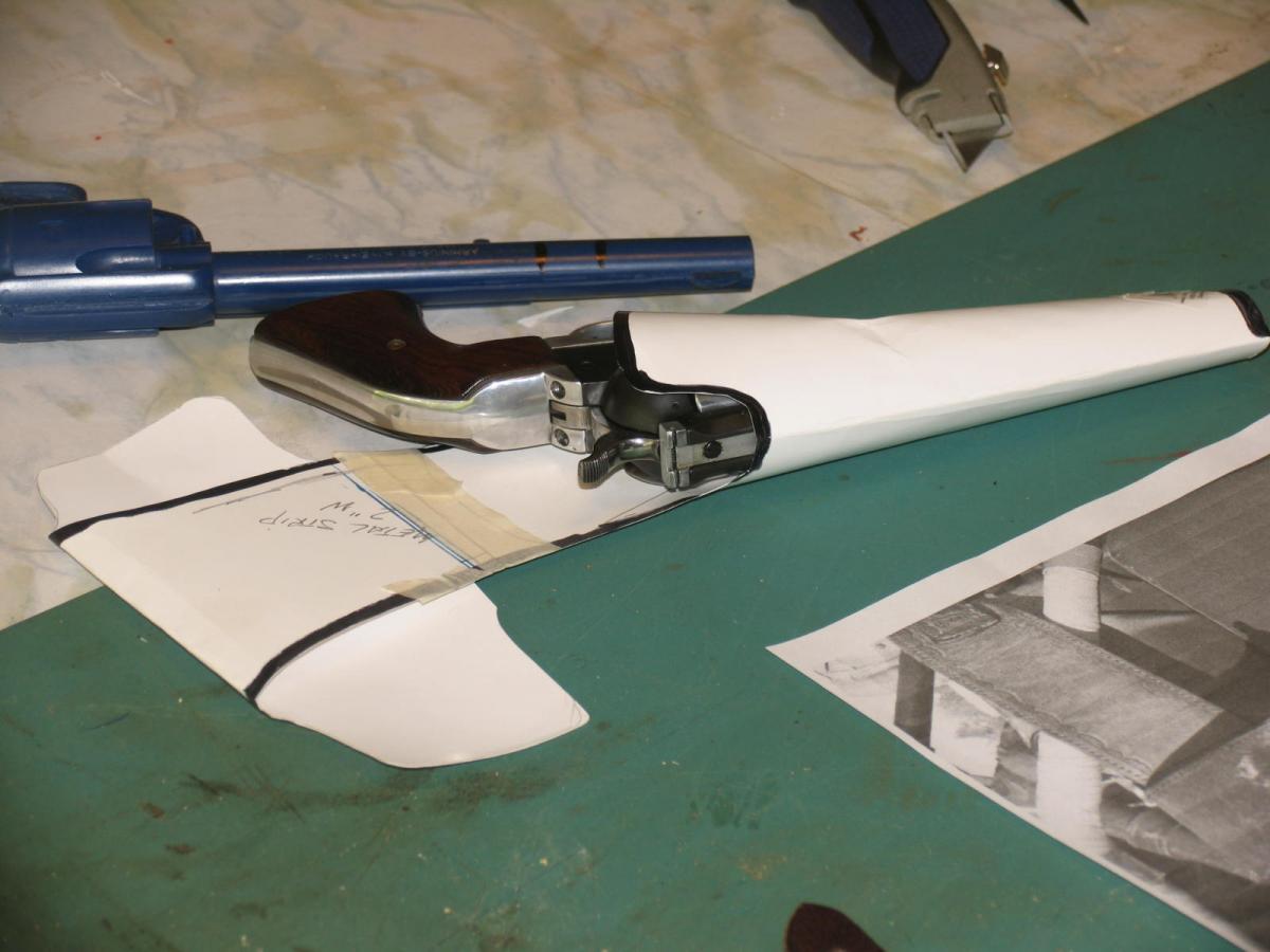

Members Red Cent Posted October 1, 2015 Author Members Report Posted October 1, 2015 50, been looking at the Air over Hydraulic. Probably be fairly soon. Was in the plan. The steel will be awful cheap if not free. And it is available. Might need to hang another set of springs on the press. And the press will need to spread its force wide. When you unfold a western holster with the skirt/flap full length, that is big. The skirt runs the full length of the holster. As you can see, I don't care for the big wide skirt. Quote https://www.facebook.com/redcentcustomleather?ref=bookmarks http://www.redcentcustomleather.com/
