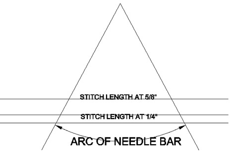

The change in stitch length is due to the pendulum effect of the needle bar pivoting from the top of the machine head. The longer the needlebar and needle combination, the greater the loss of stitch length as the thickness increases.
