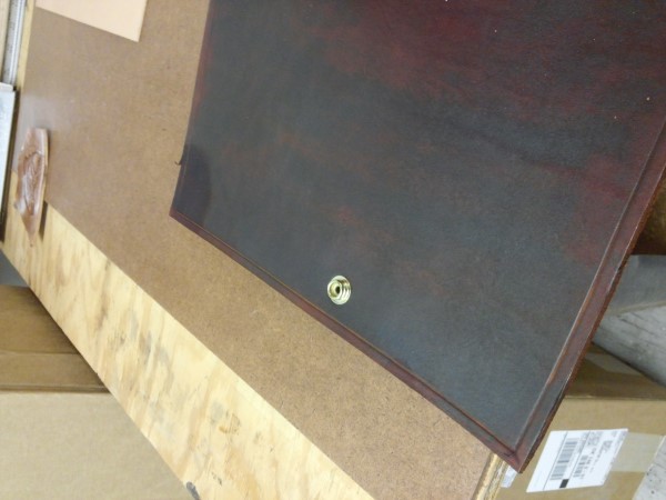

Members BillinOK Posted November 24, 2015 Members Report Posted November 24, 2015 (edited) I have some new Fiebings Light Brown Dye (plain dye). I put it on a large piece of untreated Herman Oak craftsman 7 - 8oz. First coat went on ok, other than streaking a little. Let it dry, then a second coat. Right after that, it turned a dull greenish cast. I was sick! Took some Aussie conditioner and buffed a corner and it seemed to take it out. Any ideas? Edited November 24, 2015 by BillinOK Quote
Members billybopp Posted November 24, 2015 Members Report Posted November 24, 2015 I've seen similar greenish or bluish colors ... It seems to be some component of the dye that floats to the surface, and usually happens when the dye it put on heavy. Not completely sure what it is or what causes it, but It does rub off, tho. Bill Quote
terrymac Posted November 24, 2015 Report Posted November 24, 2015 Nature of the beast. I do not know why it happens, it just does. Clearlac, Tankote, or Tandys conditioner all seem to remove it just fine, and it looks ok Terry Quote
Members BillinOK Posted November 24, 2015 Members Report Posted November 24, 2015 I talked to Springfield Leather. In my case (plain Fiebings dye), "The greenish glow/tint is happening because there is too much dye to absorb into the leather and the pigment that is left after the alcohol evaporates sits on the top and creates that situation. " Also suggested using dye reducer. I don't know if you can use that with the pastes. Fiebings leather site suggested cleaning the leather first with the glazer or denatured alcohol. In my case, I may try the denatured alcohol and see if that helps any. Quote
