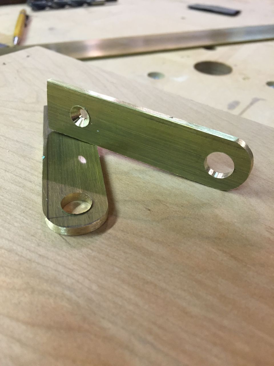

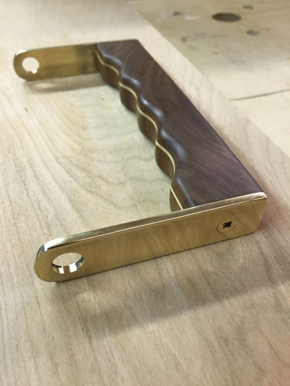

5 Spice Report post Posted December 2, 2015 Here are a couple of other shots of the handle in process Quote Share this post Link to post Share on other sites
