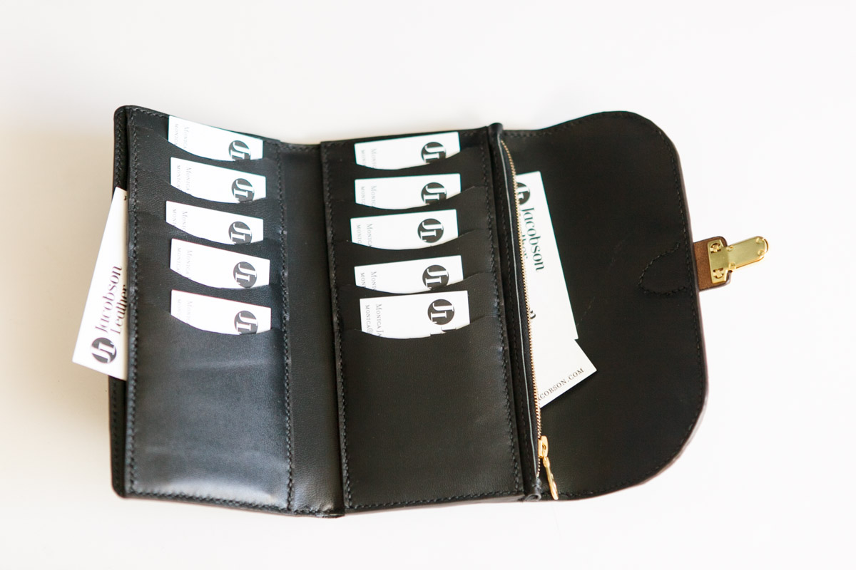

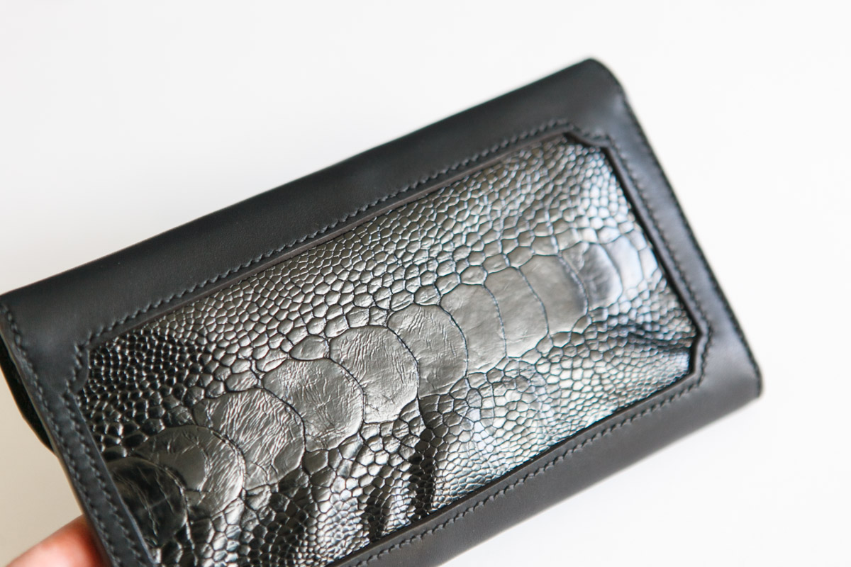

Members MonicaJacobson Posted January 5, 2016 Members Report Posted January 5, 2016 Show off, kind of... not at all. This one was a flop - oh, it's a nice wallet, but it's has three too many devastating mistakes. First, this was my first time using ostrich shin inlay, and i didn't think to glue it down on something else before I glued it to the exterior of the wallet, so I couldn't get it smooth enough. Then, I cut the exterior larger so I could trim it down flush, but that required that I get everything aligned properly, which I did not manage to do. Thus, very crooked inlay. I guess I'll have to re-think my procedure. Oh well. Kidskin interior, Horween essex exterior, handsewn with tiger thread, 8spi. Quote
Members grmnsplx Posted January 5, 2016 Members Report Posted January 5, 2016 I see what you mean bout the inlay. Excellent design though. Looks great. Will you try it again? Also, what the Essex like? Quote
Members Tugadude Posted January 5, 2016 Members Report Posted January 5, 2016 Great potential and cool design. With your skills I am not following why the cutout for the inlay wasn't squared up. I agree some stiffener on the ostrich skin is in order. Still, I'd bet someone would be thrilled to have a nice, functional wallet even if it isn't up to your usual standards. Quote

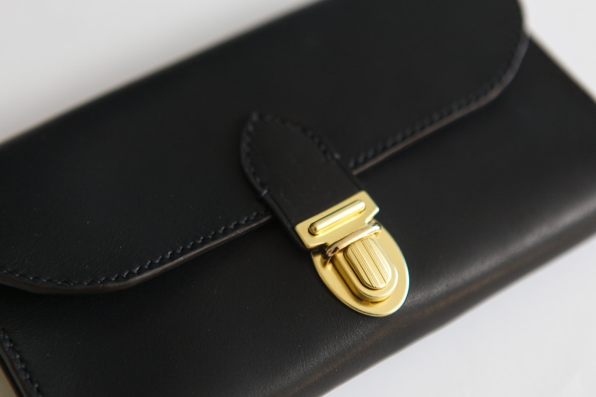

Members thefanninator Posted January 9, 2016 Members Report Posted January 9, 2016 Nice work Monica. I like the brass catch... and you creased the edge, looks nice. Only thing I might have done is line the back of the catch piece. Quote
Members MonicaJacobson Posted January 9, 2016 Author Members Report Posted January 9, 2016 @MY63 - Nice, I've seen that bird image several times, and wondered how it would look carved into leather. It works surprisingly well. The red cylinder case is sweet. I've been wanting to do something like that, but have chickened out for various reasons. What kind of leather did you use on the refit of the gladstone bag? Did you mean the leather foxes I've done or the tagua nut ones? If you mean tagua, I never got beyond beginner carving, and I used a dremel. My lack of skill with perspective got in the way. @Chris - thanks! I did crease that one piece of horse - I keep meaning to send you a bunch of creasing questions, since you have the actual tool. About lining the catch piece - I don't think you can. Until you bend the piece, it won't even go into the clasp. I don't think you could add lining to it and have it fit. I did wonder about that, though. Quote
