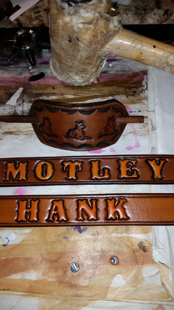

I use 2 products exclusively. 95% of the time, I use full strength acrylic floor wax - Mop 'n Glo. I apply 2 -3 coats, allowing at least 4-6 hours between.. usually closer to 8+ hours.
I use Fiebings oil dye almost exclusively after the final dry. I use a sponge to apply quickly and evenly and a paper towel to dab up any excess on the resisted areas... mainly the grooves left from the stamps. Otherwise, if you have missed getting the resist down in the groove, the dye can leech under the resist.
Now, this method does not block 100% of the dye penetrating, but gives a contrasting effect. Different colors seem to give different results.
Now, for even better protection, you can use Woodlands Latex Rubber. Paint on 3 heavy coats, letting each dry totally. As with the wax, you must get down in the grooves, or you'll have ugly streaks and splotches. Once you dye, peel the rubber off and you;ll have pretty much bare leather underneath.
A couple of points.... Apply your dye quickly and as lightly as possible. The heavier the sponge is loaded with dye, the more bleed through you'll have. You just need to practice to see the effects of different techniques.
Next, you can not dip dye using thiese techniques.
Finally, if you dye the back side, you have a much greater chance of the dye showing under the resist.
I'll try to attach a photo or 2 here.
Good luck
