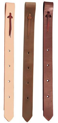

Thor Posted April 22, 2016 Report Posted April 22, 2016 I'm just reading through the ASMA website and stumbled upon some terms that left me guessing. I'm hoping someone can turn on the light for me here. They're writing here http://saddlemakers.org/id393.htm OFF BILLETS While single ply off billets are common in the industry, as a matter of policy and safety, ASMA recommends that single ply leather off billets not be used. It has been noted that the single ply leather off billets have a tendency to have a high failure rate. If single ply leather off billets are to be used it is recommended that they be made of heavy ( 13/14 oz+ ) skirting leather. I haven't seen any layered off billet yet or am I just not understanding this correct? To me this: is a single ply off billet. What's wrong about this type of off billet? None of them ever failed on me. Or are these considered to be layered cause they are "doubled" upon the fold? Further, what's the difference between a latigo and a half breed latigo? Somebody turn the light on for me please. Quote
Members Goldshot Ron Posted April 22, 2016 Members Report Posted April 22, 2016 Thor, The photos you posted are as you stated single ply off billets. However, you can use a latigo billet just like the on side latigo, so you have two latigos on your saddle; or, you can use a half breed billet. It is shorter than the on side billet, and is attached differently. A two ply off billet is basically two lengths of leather sewn together. The tongue of the cinch is going toward four layers of leather, and two layers of leather are going over your rigging plate (hence, it should be stronger than a single ply). It has been my experience that billets fail not while riding, but when the horse is tied and you turn your back to do something. The horse does something weird, and the saddle is on the ground with the billet torn in half. Ron Quote
Thor Posted April 22, 2016 Author Report Posted April 22, 2016 Ron, thank you so much for clarifying that for me. I was aware of the "two latigo" thingy, but not of that terminology. Now if I'm going to make a two ply off billet what thickness would I use? Obviously if I'm going to use 2 layers of 7/8 oz. that would turn into a sturdy 14/16 oz. off billet. Would a 6/7 oz. leather be sufficient as this would meet the requirements outlined above for an acceptable single ply off billet? And if I wanted to add additional strength, but not a lot more thickness, could I add heavy duty webbing to that? Thor Quote
