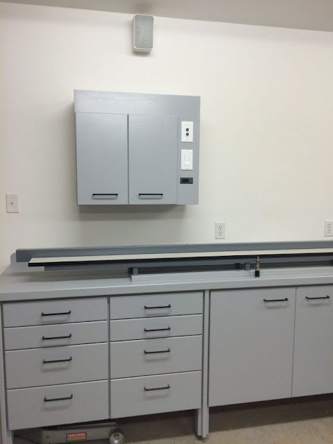

Members msdeluca Posted October 9, 2016 Members Report Posted October 9, 2016 Painted the box and doors and am in the process of wiring it up. Tested the fans and variable speed controls, they are working great. This photo shows the thermostat being wired. Thermostat barely fit the 3/4" material thickness, but it snapped into place. All the wires are now pulled into the single-gang cut-in junction box. Drilled a hole for the thermostat sensor on the right side. It is that chrome pin to the right of the screwdriver about 6" up the right side. I'll probably silicone it in place. Write up and resources... Quote Michael www.conceptleather.blogspot.com www.temptedthreads@blogspot.com
Members msdeluca Posted October 10, 2016 Members Report Posted October 10, 2016 140º baby...!!! I'll post up pics of the interior later. Write up and resources... Quote Michael www.conceptleather.blogspot.com www.temptedthreads@blogspot.com
Members msdeluca Posted October 10, 2016 Members Report Posted October 10, 2016 I'm anxious to try this thing...!!! Some testing results: Epoxy failed on the dowel rods. Will try J-B Weld next. Shelves can't be removed without flexing or removing doors. Will glue some extensions to the shelf cleats. Thermostat read out is consistent with oven thermometer. 120º F - 15 minutes 130º F - 22 minutes 140º F - 30 minutes Thermostat interval 140º to 137º - 2 minutes Reheat to 140º cut off - 3 minutes I may change the cycle interval from 2 degrees to 5 degrees to reduce wear and tear on the thermostat. Write up and resources... Quote Michael www.conceptleather.blogspot.com www.temptedthreads@blogspot.com

Members msdeluca Posted October 25, 2016 Members Report Posted October 25, 2016 (edited) Pegs kept failing... Bought some 10-24 all thread, cut it into 6" lengths, covered them with heat shrink tubing, and capped them brake bleeder caps I had laying around. Cannot fail now... Write up and resources... Edited October 25, 2016 by msdeluca Quote Michael www.conceptleather.blogspot.com www.temptedthreads@blogspot.com
