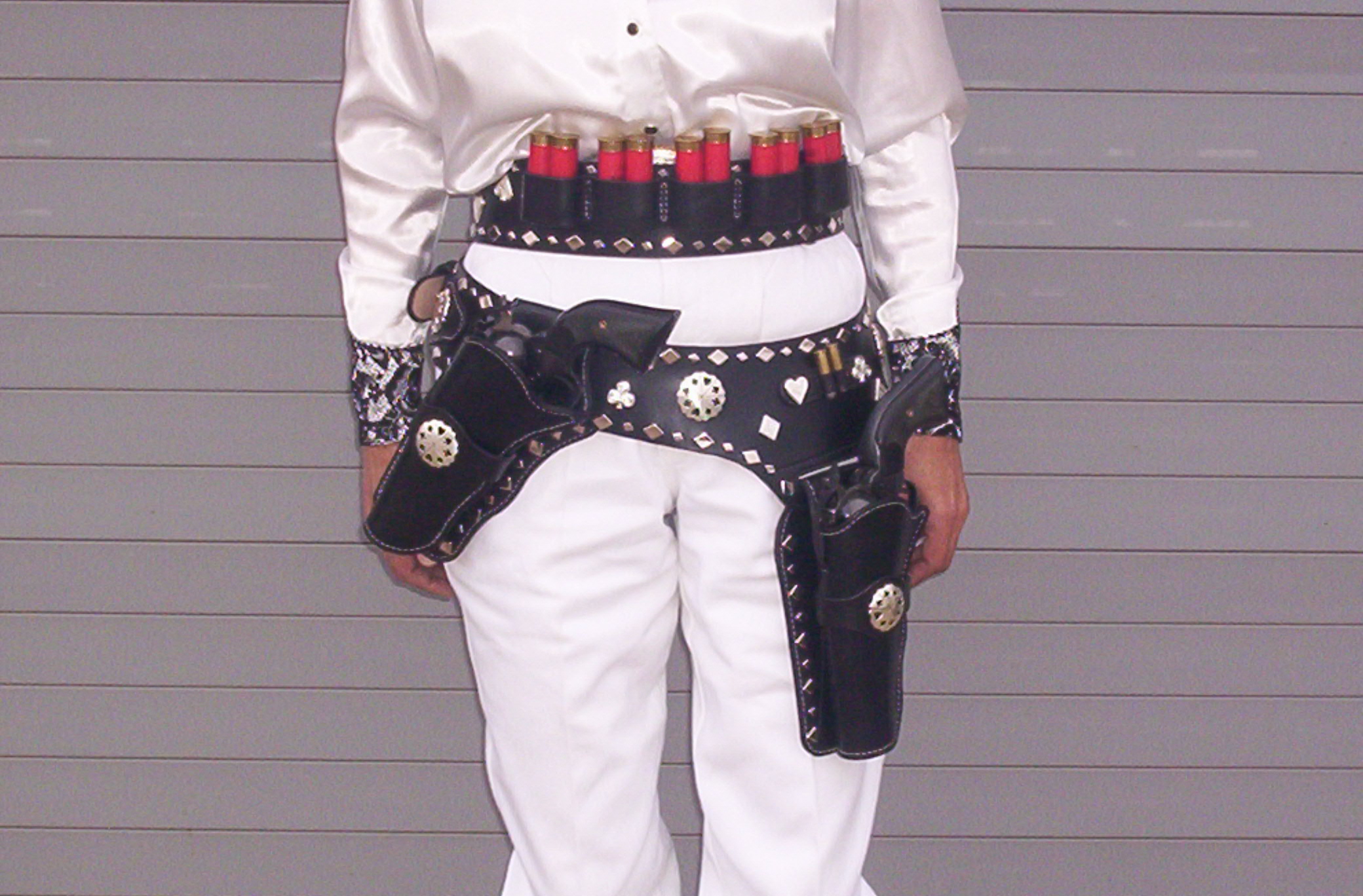

Members Jim Posted September 1, 2006 Members Report Posted September 1, 2006 I really hope I'm not sticking my foot in my mouth, here. Dyeing veg tan to a true black isn't and shouldn't be rocket science. I've seen several discussions about it and "rub off" is the major concern. I've never had that problem and I can't be that lucky [all the time] so maybe I'm doing something right. Okay, now that I'm out on the end of the limb . . . . First off, Daubers are too slow and unreliable for a complete coverage. I recommend cutting a Wool Applicator from Sheep Shealing. A 3" diameter applicator works good for large areas and a 2" dia. one works well for the small ones. Be sure to cut the wool down to about 3/8" or 1/2" in length to prevent the "dribble effect." Apply the Oil Dye (recommended) in two coats and let dry. As suggested, control it to keep it off the backside. Once dry, apply a coat of Resolene with a damp sponge and leave it set for about 30 minutes to an hour. This seals the dye and allows the leather to be used without cracking the finish. Also, rub off is out of the picture. As you can see in the photo, the leather is very black and she is wearing white clothes. Just my 2 cents. Quote Never forget where you are, so you will always remember where you've been.
