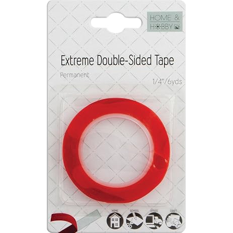

Members BDAZ Posted May 20, 2018 Members Report Posted May 20, 2018 I gave up using almost all glue a couple of years ago. I do production work of 10 to 20 pieces at a time. I make an instrument case that is approx 3" x 20" and I would often get glue on the edges or smeared on the grain side. If I had to line the cases with suede, I used a spray adhesive outside and that was also a mess, and then when windy everything stuck together. First for holding top to bottom for stitching I use double sided tape from Tandy, although there are other, better available on Amazon. You apply to the edge of one piece and then you can remove the release paper as you position the second on top. Some of my cases go a yard long so this is a useful feature. If I am lining with fabric, I use acetone to clean the edges of the fabric to promote adhesion of the tape. Another trick is I use HeatnBond to laminate linings to heavier leather. It's available at Walmart, Michaels and all fabric stores. I use a t-shirt press (an Iron works well for smaller items) and have cut my "gluing" time on a case from 1/2 hour to less than a minute. I have not had a single problem with hundreds of items delivered. It hold as well or better than most cements and glues. I still use a drop of glue here and there for touch ups. Bob Quote
Members KingsCountyLeather Posted May 20, 2018 Members Report Posted May 20, 2018 I used the rolls of double sided tape from Tandy and while it is really handy and no mess I found my needles getting caught in the glue while I was hand sewing, I’ve decided not to use it any more because of that. I don’t have as much trouble with contact adhesive and it sticks better. Quote
Members BDAZ Posted May 20, 2018 Members Report Posted May 20, 2018 I only use it for machine stitching where it works like magic. There are other types which may work better with hand stitching. One I also use is a red (release paper) tape and is more rubbery. It is also very strong but more expensive than the Tandy tape. Quote
Members Tugadude Posted May 20, 2018 Members Report Posted May 20, 2018 3 hours ago, KingsCountyLeather said: I used the rolls of double sided tape from Tandy and while it is really handy and no mess I found my needles getting caught in the glue while I was hand sewing, I’ve decided not to use it any more because of that. I don’t have as much trouble with contact adhesive and it sticks better. I've had the same issue with the tape but still use it on some items. Glue is best if you can wait for it to dry. Contact cement is awesome but you have to clean it off of the edges if it oozes out. Not difficult, just an extra step I guess. There are many projects I do where I use no adhesive. Just depends. Quote
