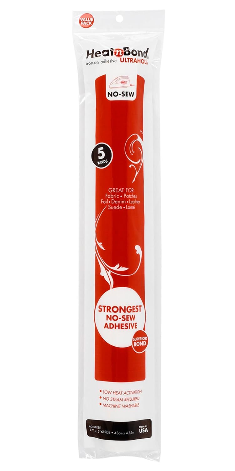

Members BDAZ Posted July 6, 2018 Author Members Report Posted July 6, 2018 5 hours ago, immiketoo said: That's fantastic. Can you post pics of your equipment and some of the blank products? Not sure what you need. My press is a standard t-shirt press: Heatn Bond: All the above purchased from Amazon. Not sure what you mean by "blank Products"? Bob Quote
