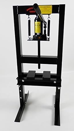

Members Matt S Posted September 13, 2018 Members Report Posted September 13, 2018 I haven't used that particular design but I use a hydraulic press for clicking, like this: I wouldn't be without it, but I find the enclosed frame to be the main limitation. I have 13" of daylight, slightly more than the press you show, and find that I have to cut a hide into strips to fit between the uprights, which eats into the time savings the machine gives. Further, I don't know how much pressure you, as the operator, will be able to bear on that press. My one uses a 6 ton lorry jack and even though most of my dies don't need this much pressure the design allows me much greater mechanical advantage. In English that means it's easy to apply lots of pressure, but it takes multiple pumps of the handle. The little press you show, however, needs all the input power to be pressed or pulled down on the lever at once, and I think that the upper limit of what the press can press will be rather low. Quote
