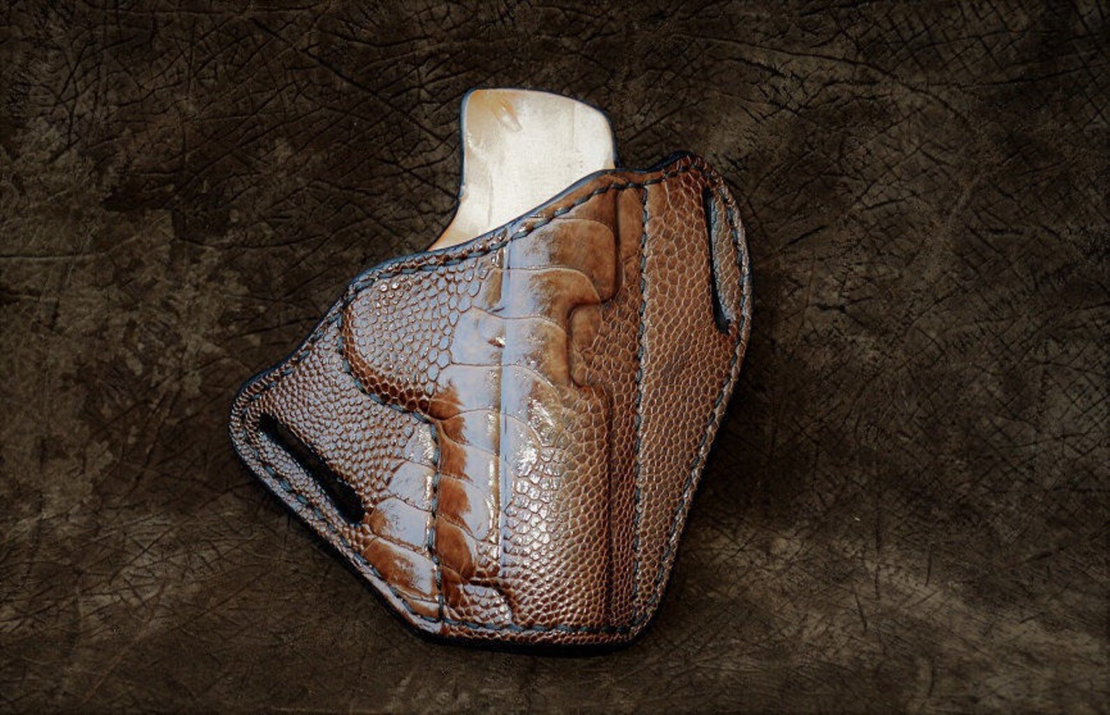

Members Brooks125 Posted August 27, 2020 Members Report Posted August 27, 2020 What is the secret, if any, to wet molding exotics? I have done a few with snake skin, frog and now ostrich legs. I understand most exotics are essentially waterproof, but is there a way to "encourage" moldability to get the deep, incised lines you get with cowhide, or at least closer to it? Here's an example of my last ostrich leg. The interior is pretty spot on and it functions great. It's a nice holster, but I would like more front detail. Quote "Be polite. Be professional..."
Members Matt S Posted August 27, 2020 Members Report Posted August 27, 2020 I expect that they are chrome tanned, or with another process which does not respond in the same way as veg tanned hides. Is the ostrich glued to the veg tanned liner throughout? Quote

Members Brooks125 Posted August 28, 2020 Author Members Report Posted August 28, 2020 15 hours ago, Matt S said: I expect that they are chrome tanned, or with another process which does not respond in the same way as veg tanned hides. Is the ostrich glued to the veg tanned liner throughout? It is. I basically laminate the exotics to the veg tanned from the original cut outs, and all my holsters are suede lined. I'm wondering if a longer saturation before molding would be better or worse...or if the loss of detail on the boning is just to be expected. Quote "Be polite. Be professional..."
