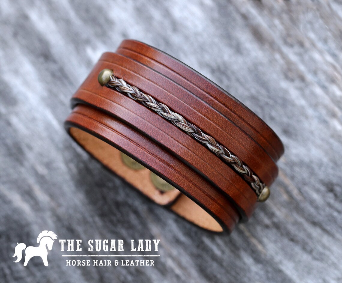

i googled for some horsehair inlayed bracelets and came up with the attached photos....Note they are not mine, just from google...
https://i.etsystatic.com/6024747/r/il/2da5fc/2033517437/il_1140xN.2033517437_balg.jpg
https://www.foreverentwined.net/leather-inlay-bracelets
