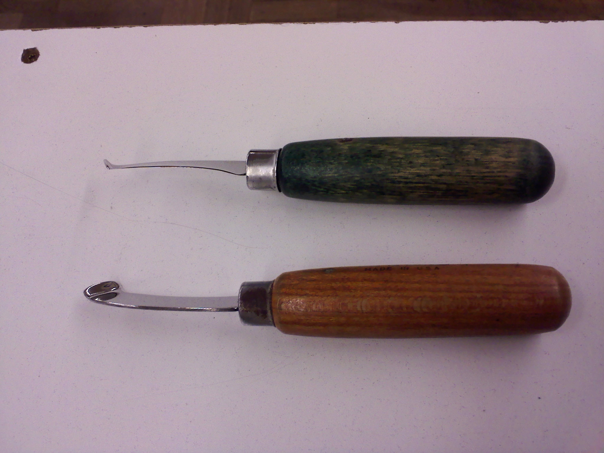

On an all leather ground seat, I too cut dry and finished. However, on a seat with a metal strainer, I rough cut as I go. I use right and left handed lip knives for this job. It is much easier to cut the curves.

A lip knife is a knife popular with shoe and bootmakers. It has a squared off tip and the tip is curved tp the right or left at about a 90 degree angle. The "lip" is not sharpened, and the length of the blade is only sharpened on the outside creating a curved blade. The curve allows the blade to cut only curved lines. Thus the right and left knives. I believe that Panhandle leather stocks them. http://www.panhandleleather.com/ They are fairly in-expensive.

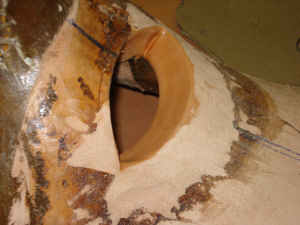

I cut my handhole after the whole seat is dry as well (all leather seat). I do the same as others by poking an awl up through the center of the groundwork. I use calipers to mark arcs for both the front and back of the handhole and use a round knife to cut the hole out. Mine are slightly wider than the space between the bars... ie. if the bar gap is 4"s wide my handhole is 4 3/8" wide; you can see the top edges of the bars in the first photo. I do this cause I find it easier to attach the skirts in the corners of the handhole. If need be I use a tiny little wooden spokeshave to clean up the back side of the fork and the front edge of the ground work. If you look at the top of the second photo you can see the leather is taken down almost completely to the tree. Some people put a plug on the back side of the fork to clean up the groundwork. I extend my gullet cover through the handhole and up the back side of the fork and then use my small spokeshave to clean it up to the final shape I want showing through my fork cover.
The last photo is a paper pattern of the the piece of leather I use to cover the front of the groundwork. It ends up looking almost identical to what Andy does. The edge on the bottom side of the ground seat is pinked and held in place with ring shank escutcheon pins and the top is glued down and skived to blend with the ground seat.

Andy- thanks for the pictures- they said more than a thousand words. As hard as I thought about it I couldn't wrap my head around such a simple solution. You've been very helpfull with all my past questions about ground seats and I really appreciate it.
Darc- thanks also for the pictures- I really liked your idea of extending the gullet cover to help clean up the back of the fork. Wish I would have asked the question a little sooner.
