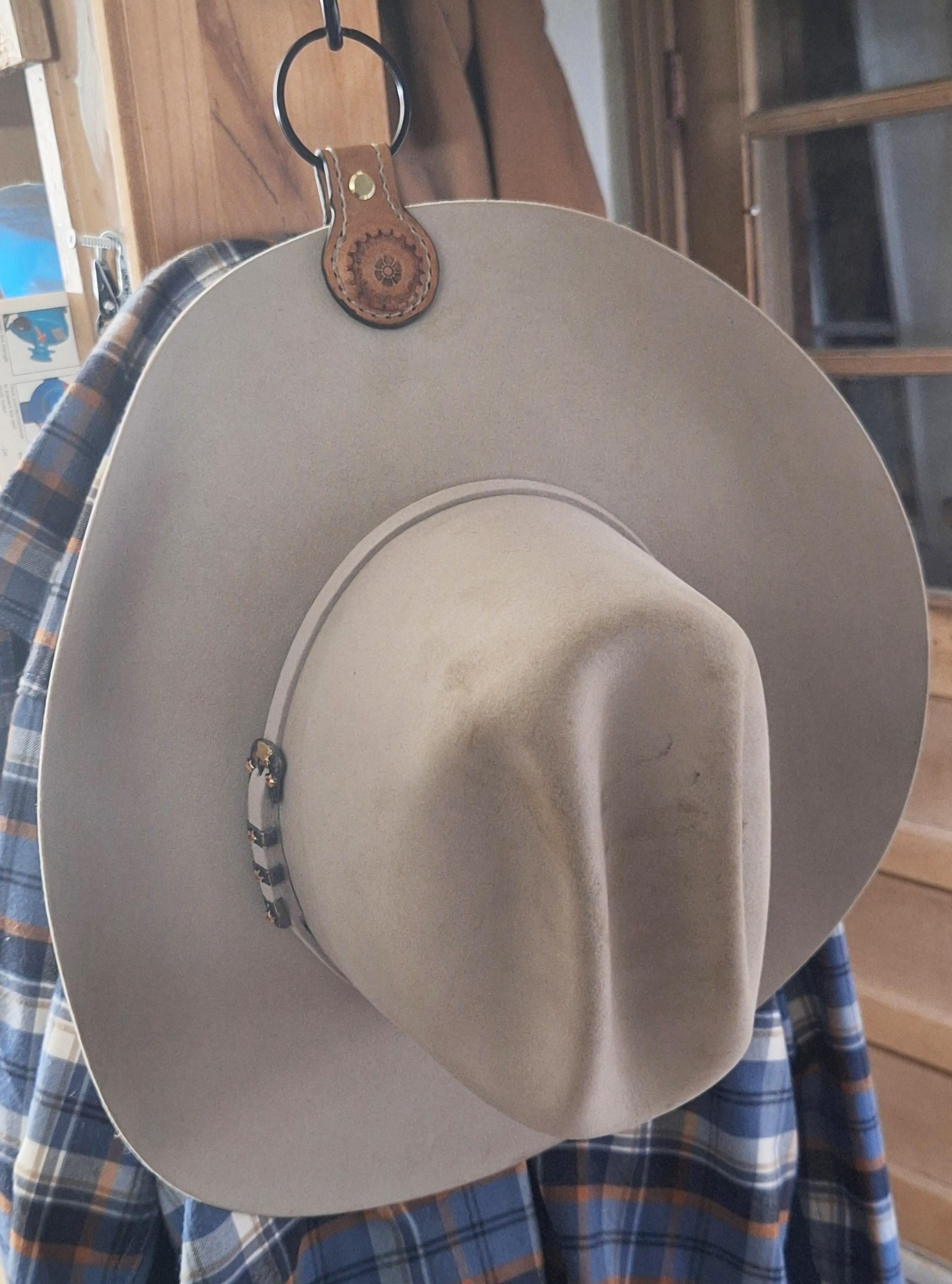

The hat came yesterday, used a little tape to shrink it, long oval seems to fit good. After wearing it a couple days it has shaped to my head and is very comfortable. It is show in the photo already dirty, hard to keep hands clean and run a farm. Put the hat on and had to grease the tractor, it is a tool much the same as the tractor. Thank you for the kind words, have had good teachers who I have not met in person. Your welcome. I got some yesterday and they work much better, this hat clamp used them.
